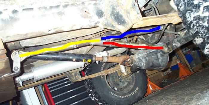

Originally Posted by davido
John, a couple of things:
1. Why do both arms have to go all the way to the end? I realize that it has to be something strong to prevent from bending (either permanently or just temporarily under load), but besides that is there any other reasoning to have them both run all the way to the shackle end?
As a side note, I was thinking that they needed to be heims or something similarly hard mounted at all ends. But after looking around, a lot of the designs use rubber bushings at several places which I would think would give it as much or more play under load than the deflection of a single shaft (like in the Billavista design).
2. If that's the case on the Jeepsaholic one, then if I used it on my front (with shackle reversal) it should actually move the pinion UP, not down down as it droops. Right?
