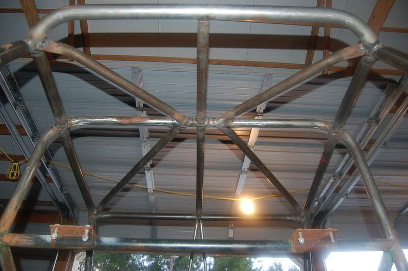

damn that looks good. I think brian's right about the nodes though...may be worth replacing 4 tubes

yeah but if you make them come together at the same point it is damn near impossible to get them notched tight and go into place
it also depends on how you design the cage, if you do it like you did eds then it is near impossible, but if you do it like most jeeps seem to be done and i think this is what it looked like robbie had done (i cant see pictures when i am at work), no halo, then you could make them come together at the same point, you would just need some extra hands to hold the pieces or something like that
I think it is the halo that makes it alot harder

looking sweet. i really like that the dash bar is under the cowl eyebrow.
:gigem: looks good Roberto!
Thanks. Almost done burning it all in, just had to take a break since it's so damn hot.
I made the dash bar below the cowl so I would have more visibility since I'm not running a stock windshield or dash, plus it's something different.

Pics of the cage burned in.
http://img.photobucket.com/albums/v4...05/cage023.jpg
http://img.photobucket.com/albums/v4...05/cage027.jpg

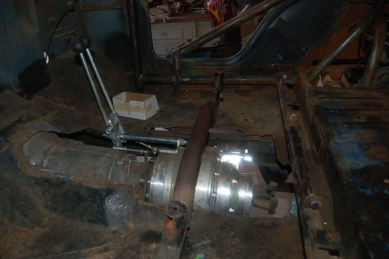

Trans/T-case seat mount hoop
http://img.photobucket.com/albums/v4...05/cage024.jpg
