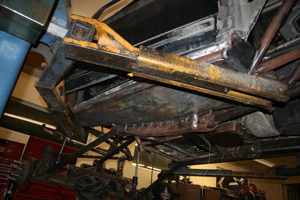

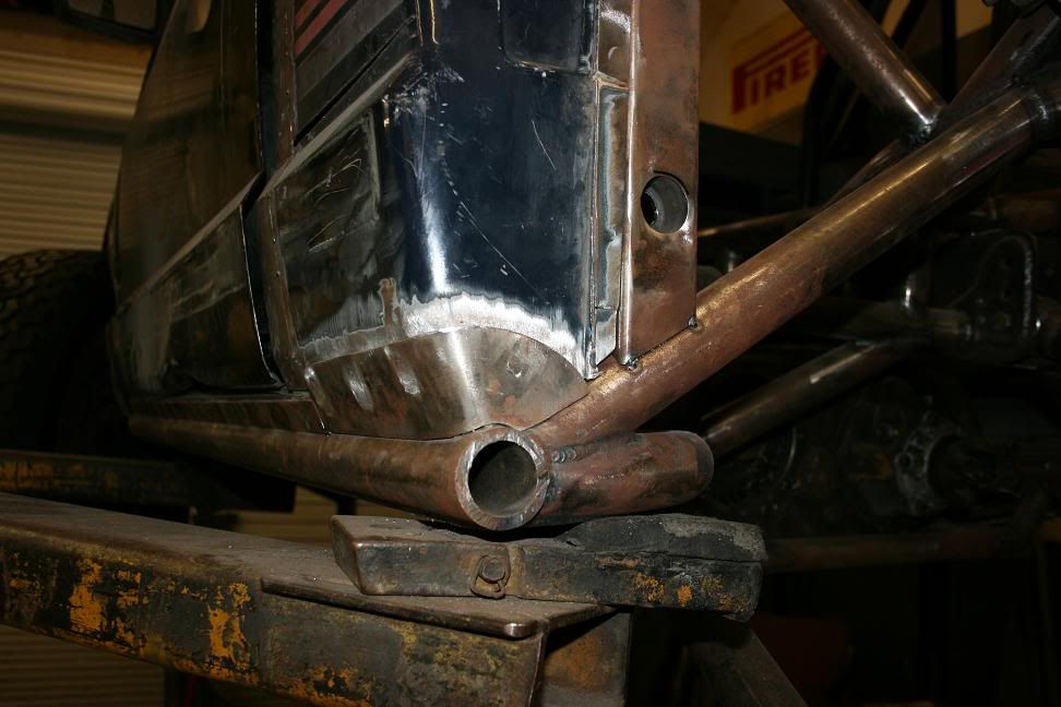

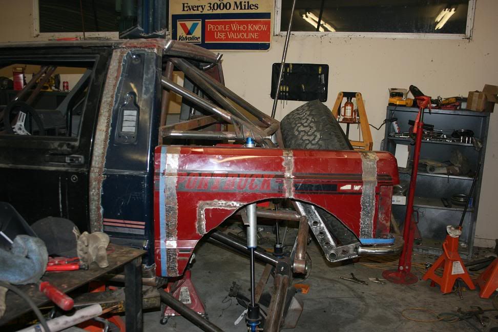

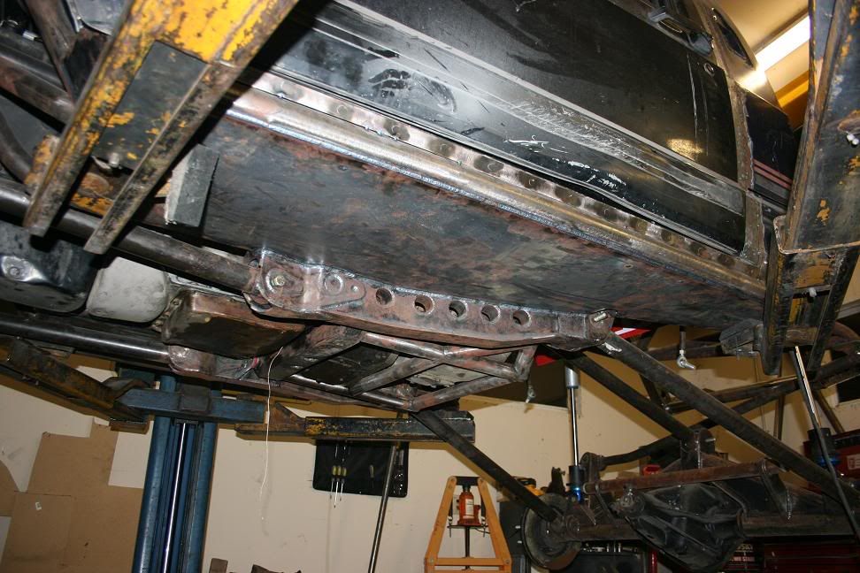

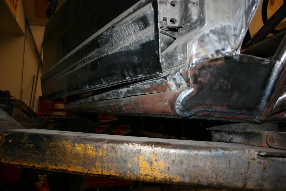

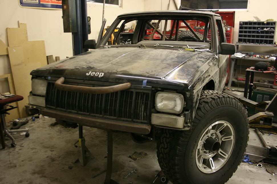

Was over at Ryan's this weekend. A lot of welding work has been done. He's got all the chassis structure welded back together and has been finishing up the rockers and building a spare tire rack/rear bumper setup. He's also been working on hanging the rear bedsides and mocking up the front end. The hood fits without any cutting of the structure to clear the coilovers.
http://i186.photobucket.com/albums/x...ne/rocker1.jpg
http://i186.photobucket.com/albums/x...ne/rocker2.jpg
http://i186.photobucket.com/albums/x...ne/rocker3.jpg
http://i186.photobucket.com/albums/x...ne/rocker4.jpg
http://i186.photobucket.com/albums/x...ne/bedside.jpg
http://i186.photobucket.com/albums/x...cbone/hood.jpg
