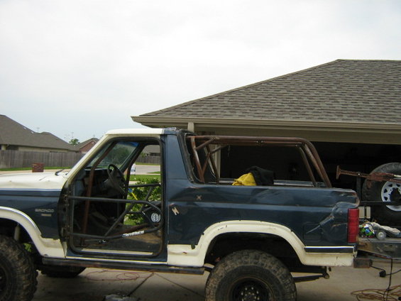

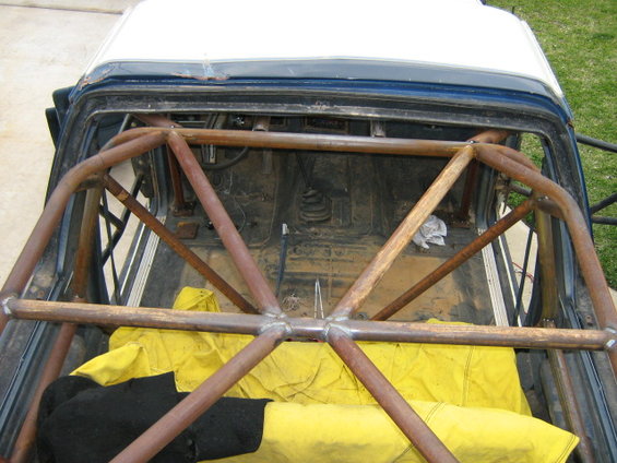

not close to being done, so don't critique it yet.

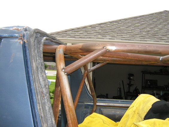

Hard for me to describe, but there will be half-halos extending off of the main hoop and two bars each going to the corners. There will be some sheetmetal work too. I ordered some Corbeaus from offroadoverstock.com ($159 a piece and free shipping) and they will be mounted to my stock sliders, then to tube running across the floor.
I am really tempted to get the double beadlocks and 39s, but not sure I can do it all for TCC.
Is that all that greg got done over spring break? Tell him to get off his ass and get to work :flipoff2:
ouch
i thought a 6.5" radius would visually look bigger than a 5.5". guess not, looks good.

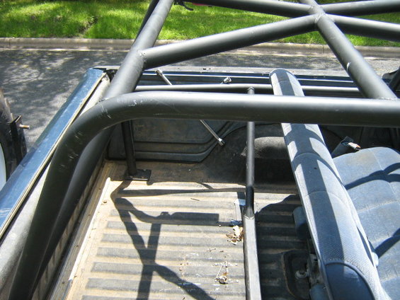

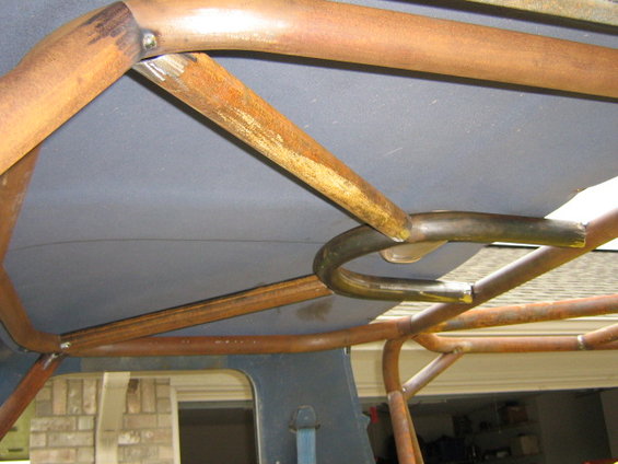

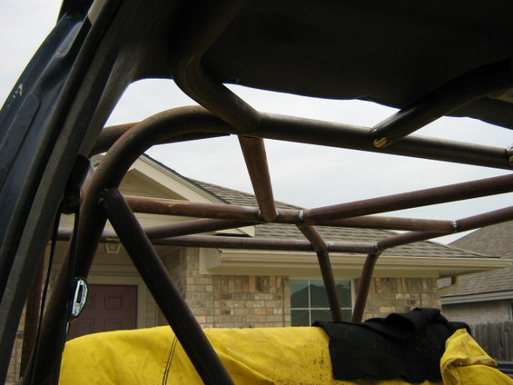

Not very good pics, but it all should fit under the hardtop. We decided against the rear halo as it would have hit any rear passengers head. Still alot to do on the rear and the front hasn't been started yet.
It also decided to leak mass quantities of trans fluid while sitting in his driveway. So yeah , gotta fix that.

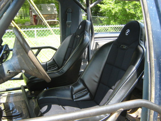

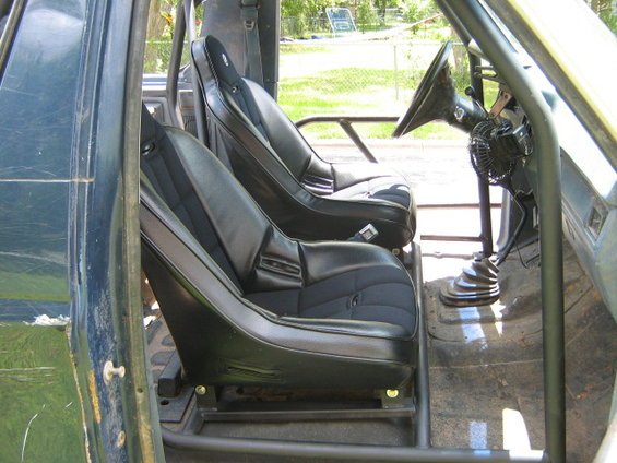

got new seats too. 159 a piece from offroadoverstock.com Corbeau fixed back in black vinyl and cloth
some progress pics. I also fixed the transmission leak

thats some rusty ass tube
its just surface rust... what tube are you using for the cage?
1.75 dom
yeah but surface rust still jacks up the bender, i won't put tube with any rust in my bender
yeah, but it isn't his bender. I'm kinda surprised greg would use that rusty of tube in his benderQuote:

Greg is welding it up tonight and is going to paint it. It still needs the dash bar and the seats bars and new seats put in, but it will be on the trailer Thursday night.

http://www.supermotors.net/getfile/5...e/img_0317.jpg
the square tube across the floor ties into the body mounts.
http://www.supermotors.net/getfile/5...e/img_0319.jpg

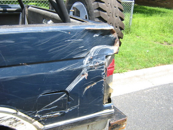

more k-rocks damage...
http://www.supermotors.net/getfile/5...e/img_0320.jpg
http://www.supermotors.net/getfile/5...e/img_0321.jpg
The cage moved alot in relation to the body at TCC, I hope the new seat "frame" will stop a little of that. But hte frame and body on this thing flex so much, I do not know if it will
