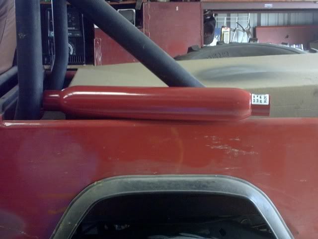

So, I decided to build exhausts. Got my muffler and started planning, couldn't find a dam place to put it. No room in the normal area. Maybe if I got a dual offset 10" long muffler. So I went to my local parts store and found the answer. Got all the driveshaft parts I need, so probably build one of those today. Seguin Driveline said they could make a driveshaft out of 2" .120" wall tubing for me, so any of yall that are into buying driveshafts may want to check there. Then work on motor problems later. Maybe even put some spacers under the coils. Also found my digital camera so I can get yall some pictures.

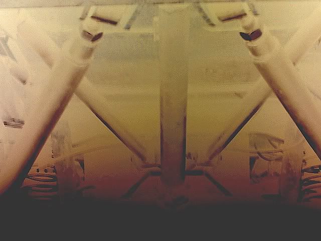

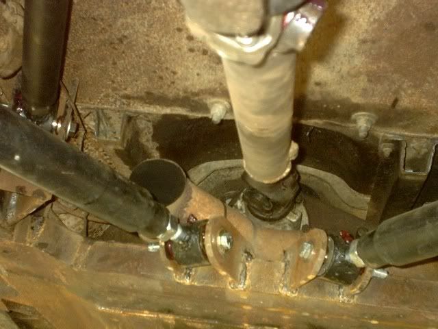

Some pics.
http://img.photobucket.com/albums/v1...ods/links2.jpg
http://img.photobucket.com/albums/v1...ods/links4.jpg
And my compact muffeling solution that matches jeep.
http://img.photobucket.com/albums/v1...ds/muffler.jpg
