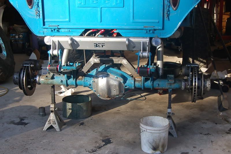

I think it will break again. you need to take the leaf packs apart leaving only the main leaf and cycle the rear suspension. then you might be able to find an arc for the traction bars that might not bind so bad. my bet is you really need to have the bars parallel rather than triangulated and the front mounting point much lower.
I agree i think that it is binding, my truss is not tied in that much more but I am sure that it will be strong enough
Already working on a pinion brace/collar that ties into the truss for added support. After I get it rolling I will cycle the suspension and make any needed adjustments, there's room to work with on the heims. Won't know until I try it out.

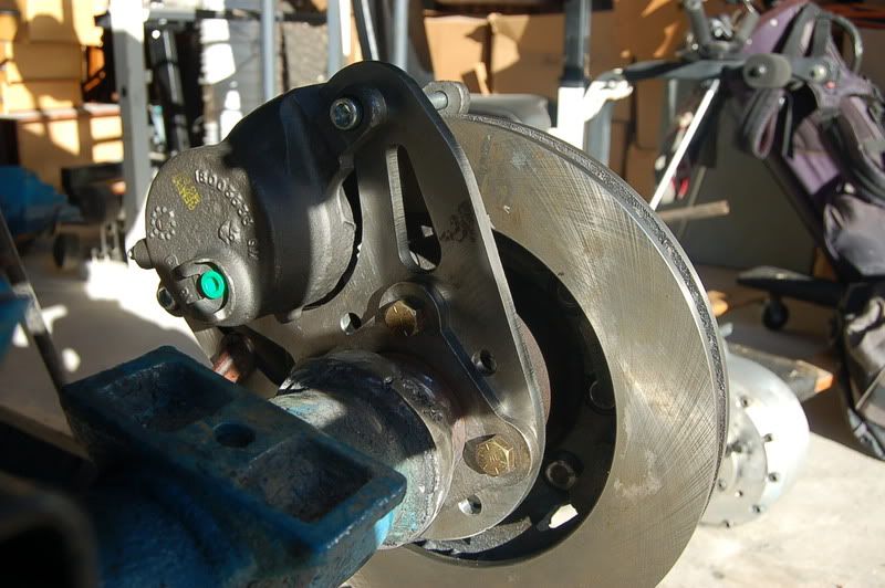

Removed the drum brackets and started on mocking up the caliper brackets, ran out of time this weekend. They'll be positioned forwards to allow the bleeders to function properly without having to remove the caliper. Need to pickup pads first though, I'll finish it up next time.

Rear disks finished, new front spring shims in, trans should be ready after spring nationals in baytown next weekend.
Test flexed the rear suspension (granted this was without a trans and t-case). The new springs are alot better, no more inverting. The anti-wrap setup cycled fine without any binding, just have to see once I take it for a spin.

In the above pics I didn't max out the suspension as the hoist wasn't liking it. There's still a little more travel left.
Forgot to mention the difference in ride height. With the new leaf's it's currently sitting level, if not a little higher than the front. Once the weight of the trans, t-case, skidplate, etc... are added the springs will settle a bit more.

Bill checked the triangulated 2-link anti-wrap setup I designed and found that the geometry was off...as one would guess. :D The truss I built has been retained but an adjustable wishbone setup is now in place. I'm not exactly sure on how it's designed since this was all described by my dad over the phone. I used the fel-pro intake manifold gaskets when I built the 383, the rear valley gasket was leaking. It's being resealed with rtv this time which should remedy the problem.
