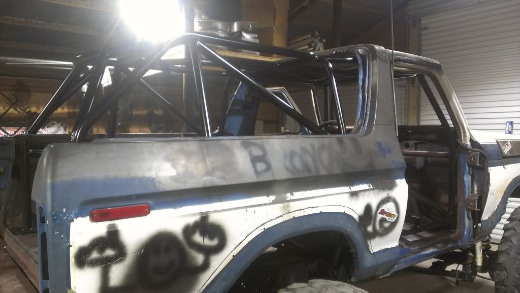

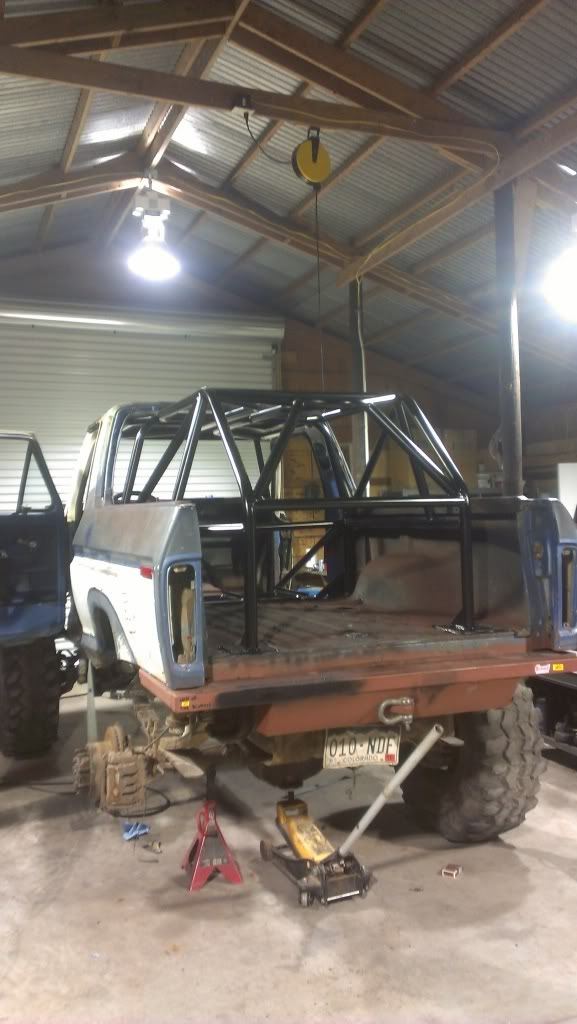

I don't want to sound too critical, but why is the back half of the cage so small? It looks like you put a small Jeep cage in the back of a full-size rig. Why didn't you follow the bodyline -outline of the rig? What's the point of a full body rig if you only built a cage to cover 30% of it - heck it doesn't even make it to the very back of the rig?
I know it's not completly fullsize, but it's still bigger than a Jeep - and has a ton of wasted space in the back half of the rig.
The work looks good, just trying to understand why it was done that way and if I'm missing some different plans in the works.
It's still pretty small, but at least you could keep an ice chest safe back there :flipoff2:
Here's the deal. I wanted a flat roof so I had to put the rear side hoops after the b pillar bends. I did bent them out but it wasn't enough after that bitch and a half notch. To give it more interior room I put the rear "window bars" perpendicular to the b pillar and then bent them in at the end to meet the side hoops. If I were to do it again I would bend the side hoops out more but I think it turned out awesome for my first tube work.
If you look at it from the back it follows the body lines better than a cage that doesn't taper in at the roof.
