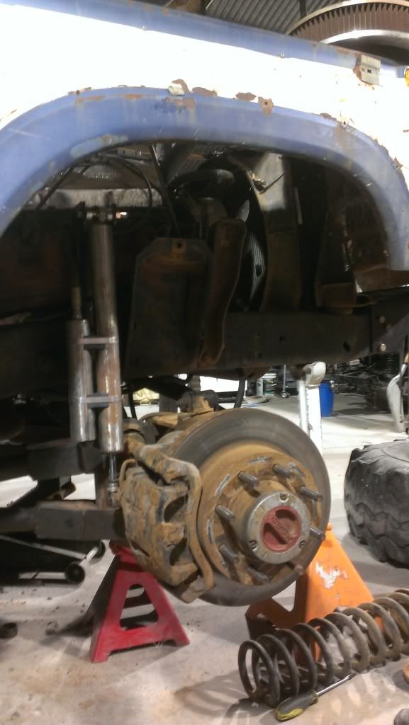

New bump stops. The stock ones were dry rotting, I broke them off with my hands. Seems I neglected these long enough because the track bar mount on the axle hit the frame. I extended them 1" so that even if the bump stop is compressed down all of it's steps i will still have about 1" before the track bar mount hits the frame.

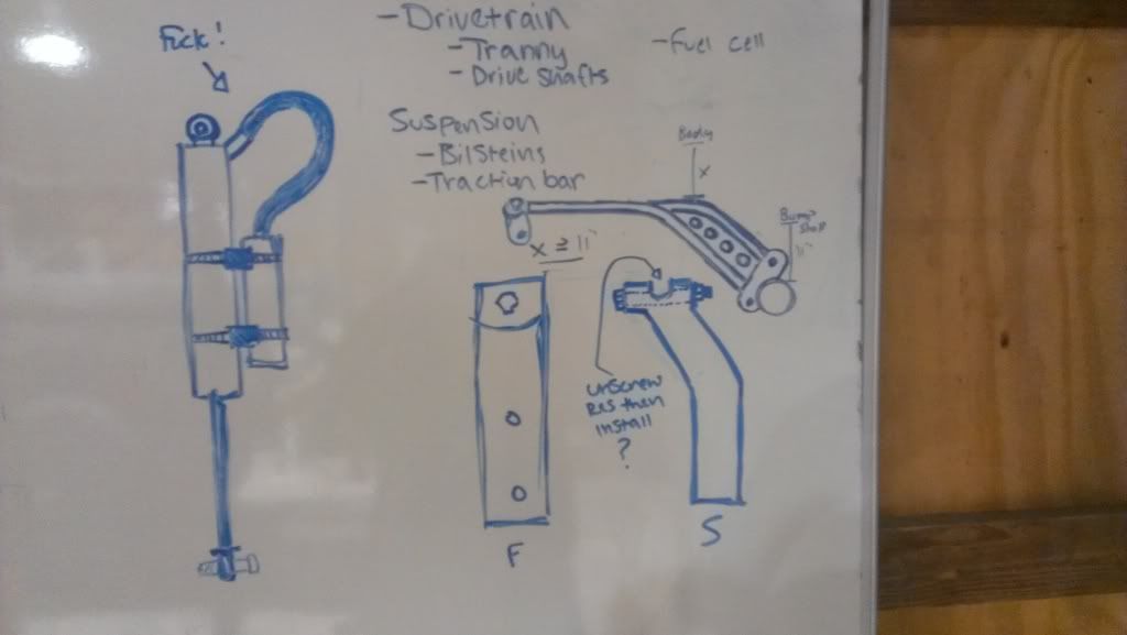

So I drew a shock.....then this design.
http://i736.photobucket.com/albums/x...ps2befcbdd.jpg
Then had some keystone and realized that was stupid
http://i736.photobucket.com/albums/x...ps56c07f7f.jpg

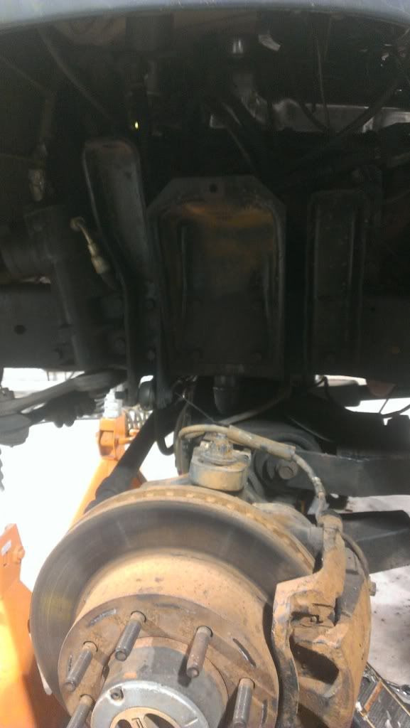

as for fixing the stink bug......the coil bucket mounting bolts go through the engine crossmember, so it'd be a bitch to redrill them. cutting coils off is kind of ghetto but I might do it.
The spring rate is too high and the front doesn't flex all the way anyways so I don't see cutting a coil reducing travel.
It might only be a small amount and might not even had been usable, but still a reduction. Aren't both ends of the spring bent to fit the buckets?
if spring rate is too high, cutting will only make it worse

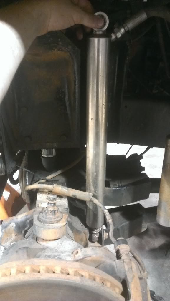

Made a shock tower.
http://i736.photobucket.com/albums/x...ps57acd8f7.jpg
Looks short. I'm guessing the axle side mount is low on the tube?
