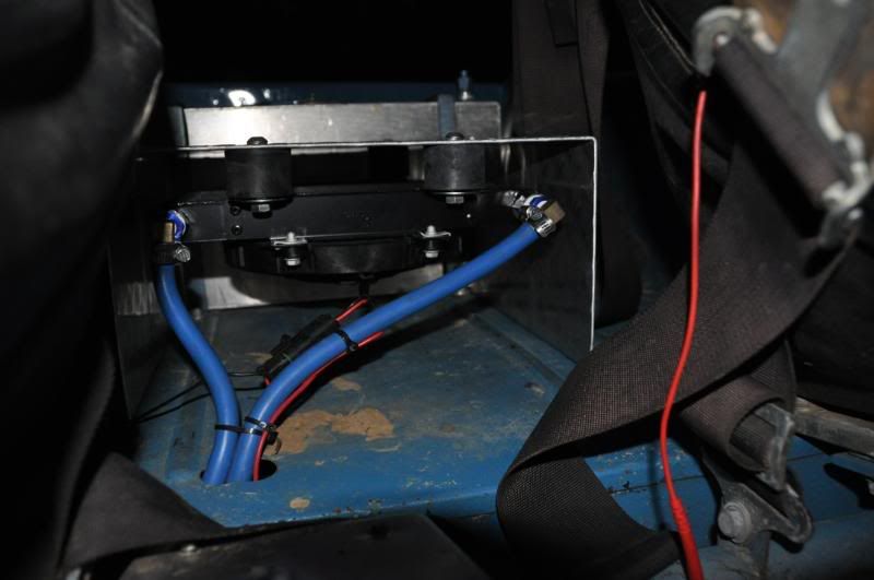

It's back together and running once again. Mounted a badass trans cooler/e-fan setup in the bed, should have no problem keeping it cool under rompage. Need to make a mount for the trans temp gauge since there is no room on the dash.

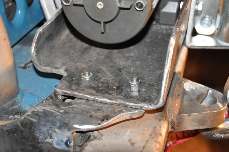

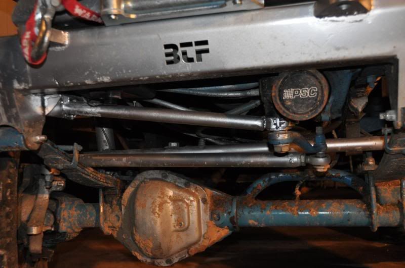

Built a winch mount yesterday using pieces from Coop's old one. Got it installed, just need to wire it up. Also welded on some d-ring mounts to the front for tow points.

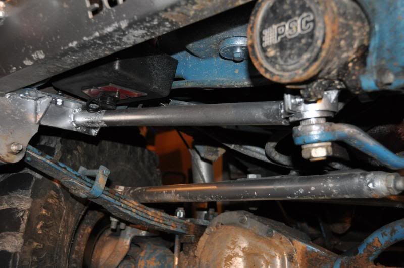

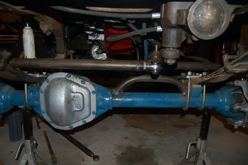

Started on a steering box brace using some scrap pieces of chromoly tubing. Not much left, just need to finish it up.

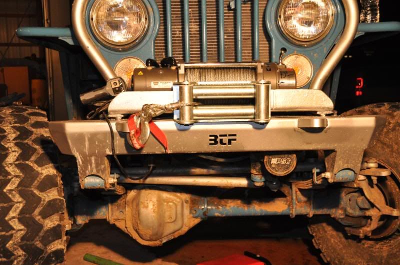

For the winch mount brackets I welded two 3/8" grade 9 bolts from underneath for the studs. Also tapped single 7/16" grade 9 bolts on each side offset for additional strength against shearing.
http://img.photobucket.com/albums/v4...05/Jeep016.jpg
Steering box brace... Mounted the winch controller box flush underneath due to lack of mounting space on the actual winch. Might move it down the road...
http://img.photobucket.com/albums/v4.../Jeep021-1.jpg
http://img.photobucket.com/albums/v4.../Jeep023-1.jpg
http://img.photobucket.com/albums/v4...05/Jeep017.jpg
http://img.photobucket.com/albums/v4...05/Jeep020.jpg
Trans cooler/fan
http://img.photobucket.com/albums/v4.../Jeep009-1.jpg
that may be the worst placement for a winch controller box that I have ever seen :)
Ya, with no mounting space on the bumper/winch and the short cable run to the terminals made my options slim. It's still easily accessible and protected by the bumper, steering box brace, etc.
That being said I plan on mounting it inside the console I'm building for the c.b. and head unit later on.
why not just put it on top of the winch motor with some very large hose clamps?
Read above... No space to mount the box on the m8000 motor, I tried it as that's how our m12000 box is mounted. The 3 motor cables have to be lengthened to mount it any further than about 10"s from the winch terminals.
i dont understand your logic, you could mount it under the winch, but you could not mount it to the motor where the wires would need to be ever shorter? maybe its just been a long week, but that doesnt make sense to me
Whacha gonna do when the front end is burried into a dirt bank or something and you need a winch pull to get up it?
