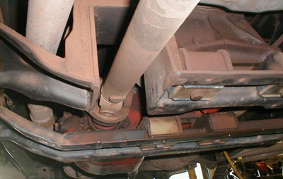

http://i736.photobucket.com/albums/x...ps6584819b.jpg
That giant hole was already there.....
Coming from experience here I would highly recommend a secondary mount to absorb the torque. Not everyone is as nice as the schubring's and willing to spend a few hours in the dark towing you off the trail cause your trans/tcase crossmember snapped and you lost all power including lights, if you do not install one you are asking for problems, especially since you have a decent V8 and you aren't afraid to use the skinny pedal
Drill tap the huge boss furd 205s have and make a foot mount to the frame. I broke three TH400 housings in Pigpen before I added the foot mount. After that, no more problems.

It's too clocked to use the factory mount. Didn't realize it before I put it in.
Problems.
-Need to Re-route fuel and brake lines so I can weld to the frame.
-Mounting holes in AL are starting to get wallowed out. Maybe I'll do a helicoil, or just use studs and nuts instead
