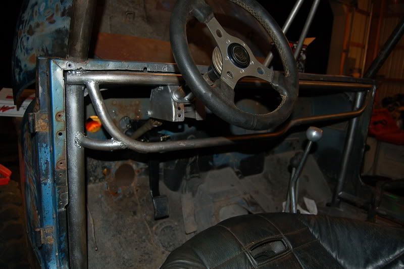

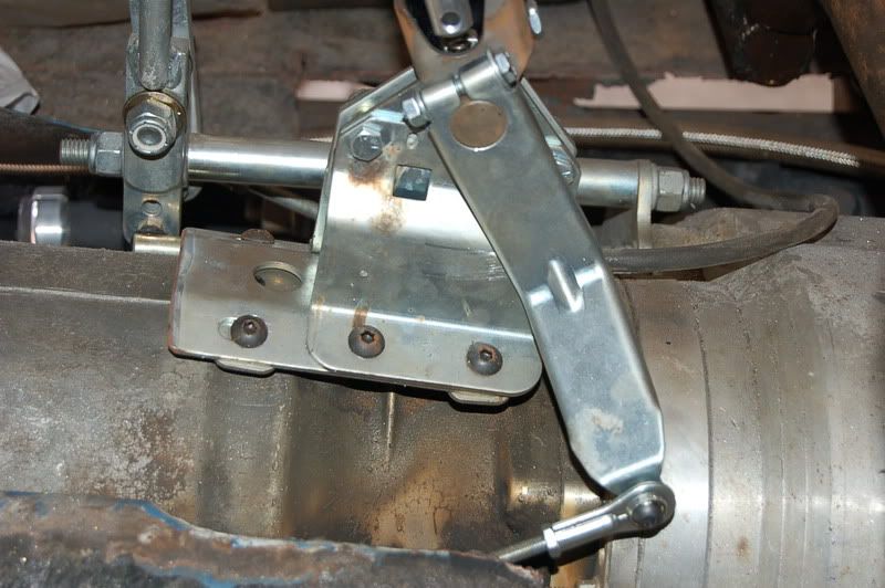

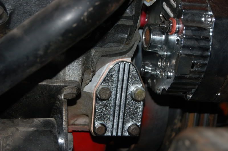

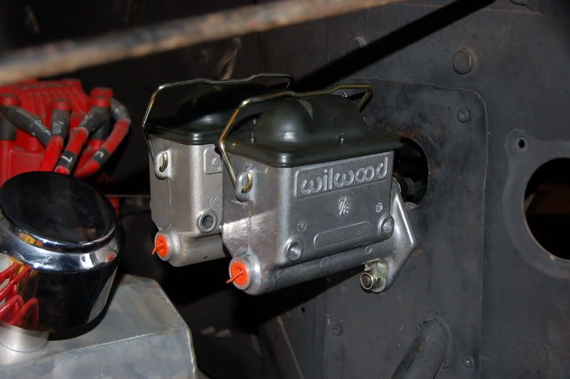

Connected trans shifter linkage, mounted "spin-on" oil filter adapter and filter, oil pressure sending unit, and pulled the pro cam mechanical fuel pump in exchange for a cover plate. Mounted brake pedal assembly, master cylinders, and prop valve.

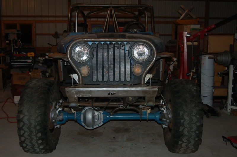

Oh yeah, that carb is gay, great on a chevelle, crap on a heep. The electric water pump is not needed but bling. We've got a mini-ram that might be cool on there, not sure what we're going to use it on.

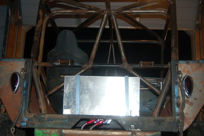

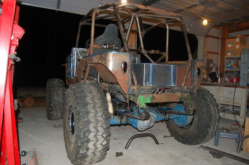

Ran the brake lines, need to pick up a couple of fittings tomorrow. Mounted the tail lights. Bent up the rear truss for the anti wrap setup.

why not drop the fuel cell down a little into the floor or move it to one side so you will have some room in the back? It's always nice to have that extra rom to transport stuff (dogs, icecheast, chairs, baby, etc...)
As for the icecheast, I'd buy one specifically for the Jeep like I did for Lynda's and make a nice mount for it. That's one thing that you'll always need to have with you on the trail...
