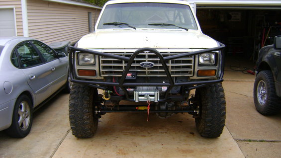

You really don't need much for a fairlead mount. You can see mine here...it's just a piece of 1/4" plate bent to a 90 and the fairlead is bolted to it.

I still have it...well, what's left of it.:p
