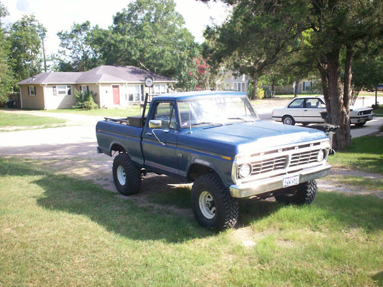

Kate Ingenloff's truck truck looked a lot like yours does
Hehe - Hes Sayin You Have A Girly Truck...
oe maybe he is saying ingelhoff is a bit manly, in a Jerry sort of way. :flipoff2:
no I liked Kate's truck, and Kate too, and at the risk of this coming out wrong she could probably hold her own against half the doods in this club in arm wrestling, spitting, and maybe even pissing for distance. Especially after her stint at the alligator farm
Originally Posted by uglyota
Was her truck a long bed?
yes and F250 blue grey two-tone....maybe a 78 too i cant remember.
