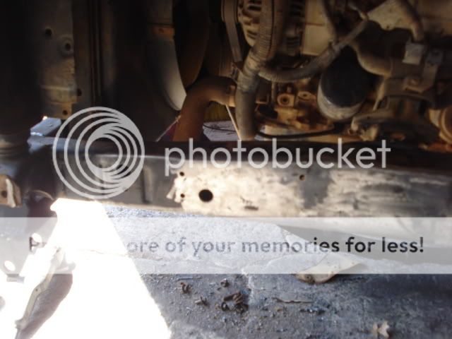

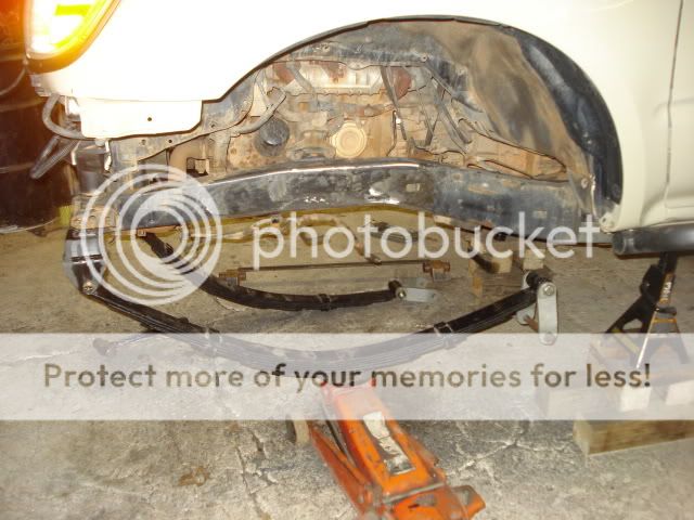

My buddy has been working on it the past couple of days and is currently changing out the oil pan to a 2WD T100 pan as I type this. He also got the steering box mounted up, the firewall plate put in, and the front spring hanger in. Tonight I am going to throw the rear diff in and reinstall the rear axles and hopefully get a mock up shot with the wheels and tires on the rear. :D
yay for springs

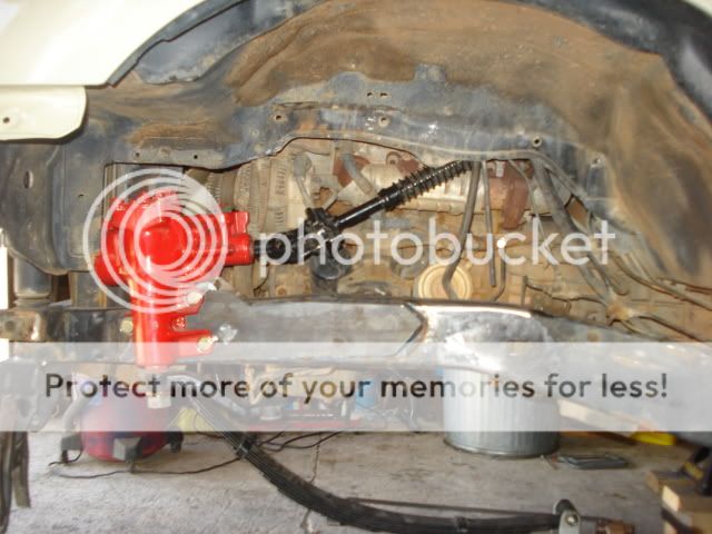

Steering box mounting

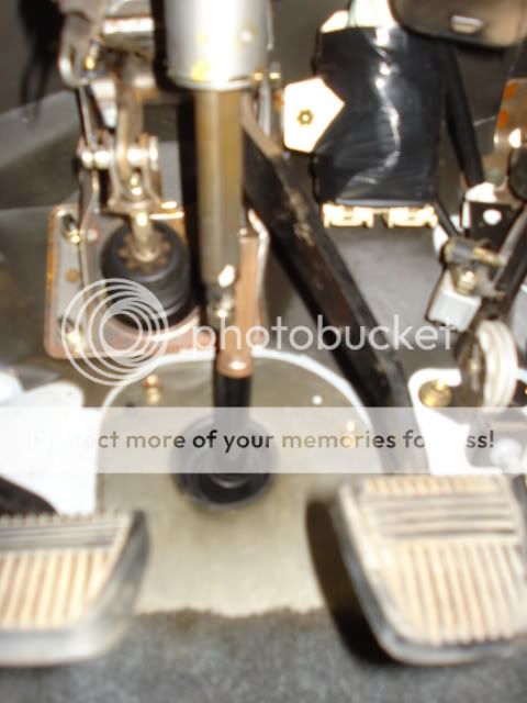

Oh I think the steering shaft I got was too long...
http://i563.photobucket.com/albums/s...o/DSC08108.jpg
it looks like that shaft has alot of splines just cut it down

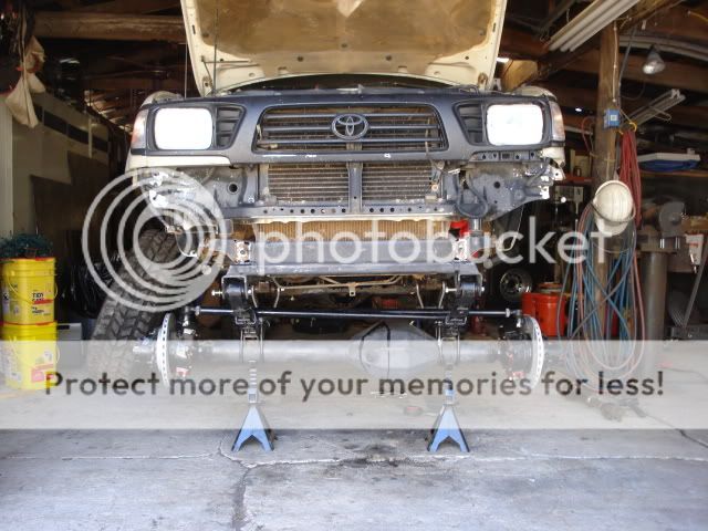

how wide is the diamond?
63"

Nah no gussets, it's a diamond. Never seen one that needed em.
