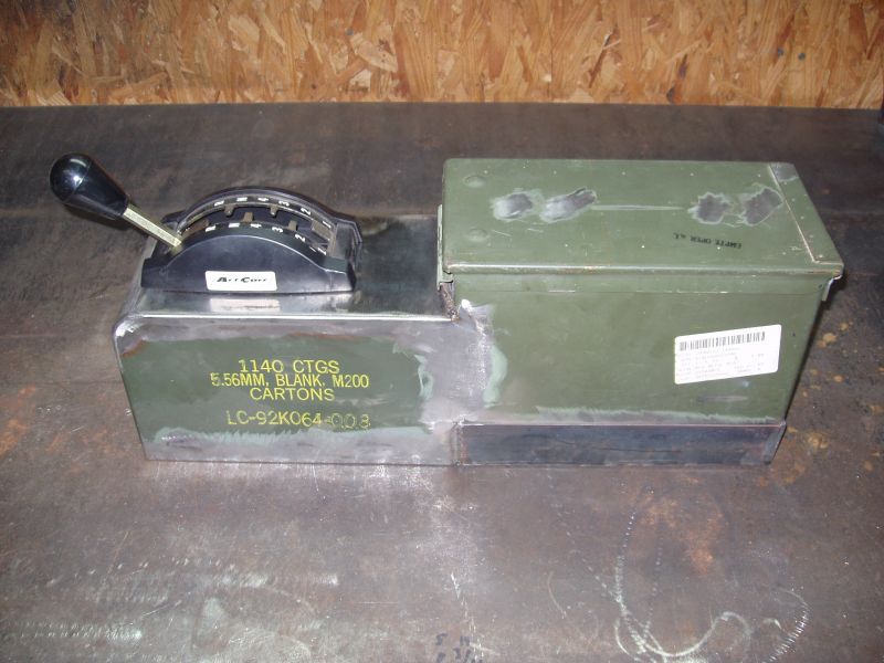

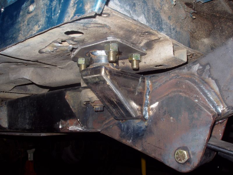

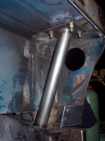

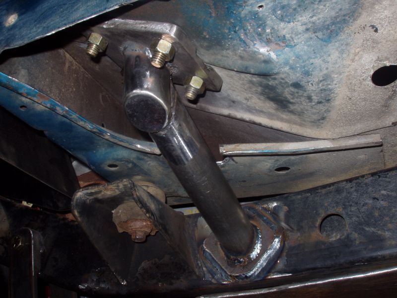

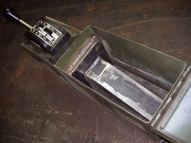

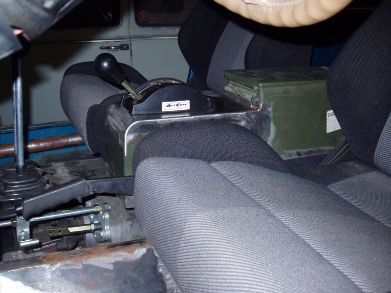

Built a center console to house the Art Carr shifter. I don't like the Art Carr plastic housing and the shifter needed to sit higher than the mounts they supply sit. I also decided to put a storage box on it. I stuck with the ammo can theme as you can see. It's still lacking a lock. The E-brake mounts to the console between the drivers seat and the console. This way you can get in and out and it will be sticking up, hard to miss, when it's set.
