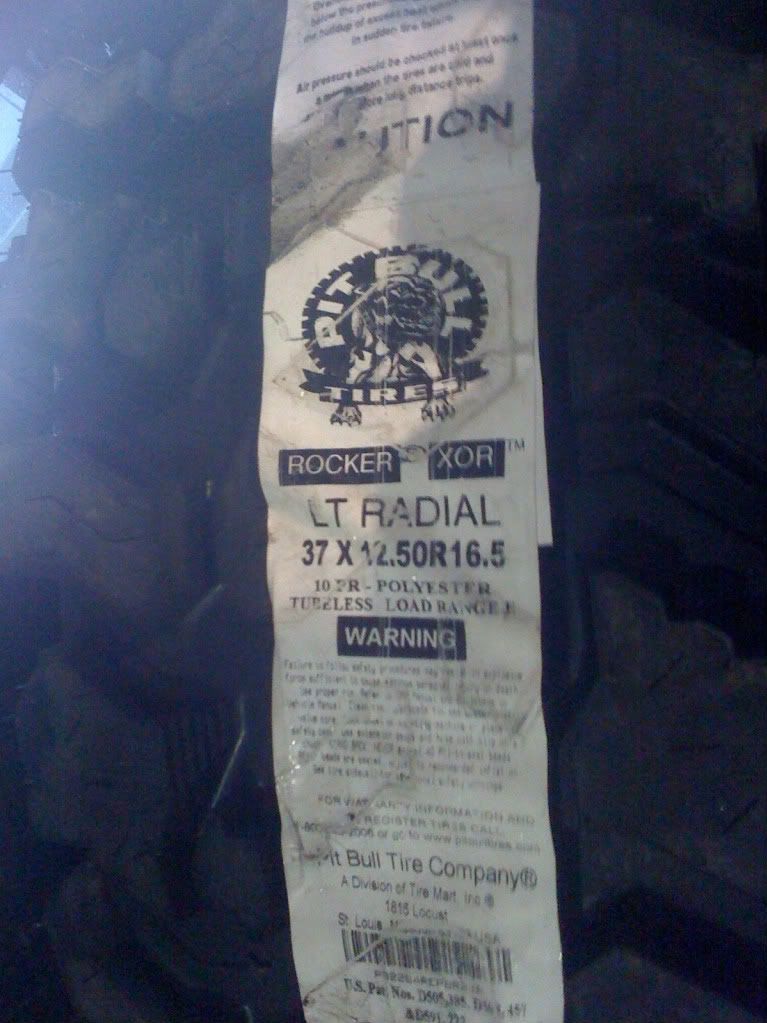

Nice! I couldn't believe you were going to all that work and putting on shatty surplus tires! That's gonna be superpimp
I had hinted to the wife what I wanted for my birthday (said tires above) and in the off chance she didn't pick up on the hint I wanted a back up plan (said shatty surplus tires). I will now have 4 shatty surplus tires for sale soon. :D
Any reason you went with radials over bias?
The bias's in 37" are 13.5" wide, and reported to be even wider than that. I like tall and skinny for the contact patch so I liked the 12.50's which measure a true 12.50. Also I am still going to be driving the Tacoma to and from the trails on occasion when it is just me camping for a couple of days so I wanted to keep the best on road manners I could and still have the Rockers.
EDIT: Looking at the invoice that came in with em, the price difference is damn near negligible, the Bias Ply's are $315 a tire and she got these radials for $321 a tire.

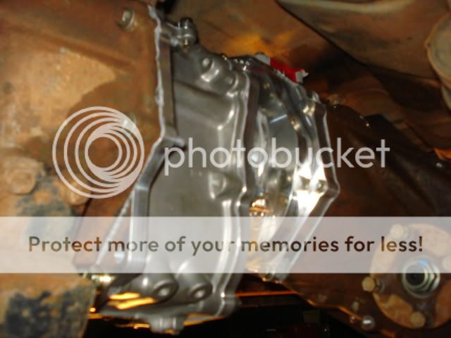

Ok pulled an H1 apart last night and damn near gave myself a hernia trying to unfawk the PVC insert from within the goodyear MT so I could install the Rockers. HA! I am ASSuming I might need some kind of special tire tools because my two prybars weren't doing the trick. I mounted the tire back on the wheel the way it was. Any suggestions on how ya'll have done these before, since I have absolutely no experience mounting these things?
Also got the Taco Box in last night, it is the only clean spot under the damn truck...
http://i563.photobucket.com/albums/s...o/DSC08158.jpg
soap, some prybars, and some ass.
turn the pvc sideways and set it on a 5 gallon bucket. Add straight liquid soap. Push down on tire.
My old usa6x6 inserts have a bit of give to them, so they are much easier to put in and take out than a true piece of pvc pipe.
