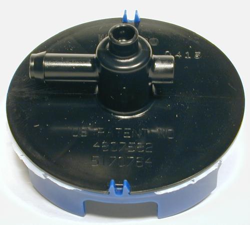

walbro makes a version of that pick-up too
Those are walbro.Quote:

yeah, didnt look at the second link. same place i got mine.
