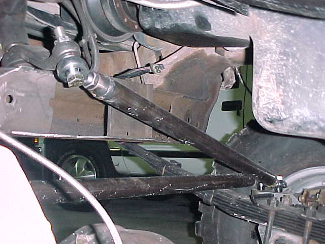

does it still look like this?:
http://www.tamor.org/forums/attachme...tid=4116&stc=1
just drill a hole in the bolt in line with one of the ears on that castellated nut and slip a cotter in it

no no no not that nut, the pitman arm nut the one that holds the arm to the box shaft, but yes it still does look like that.
