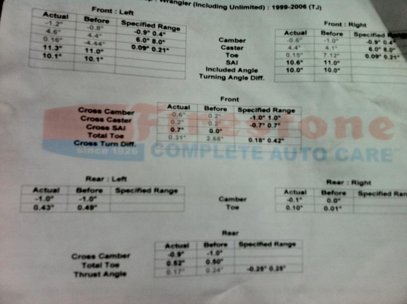

Attachment 19073
this is from the alignment firestone just did.
there was a problem before the lift, where there was no caster issue, so we dont see how it can just be the caster.
