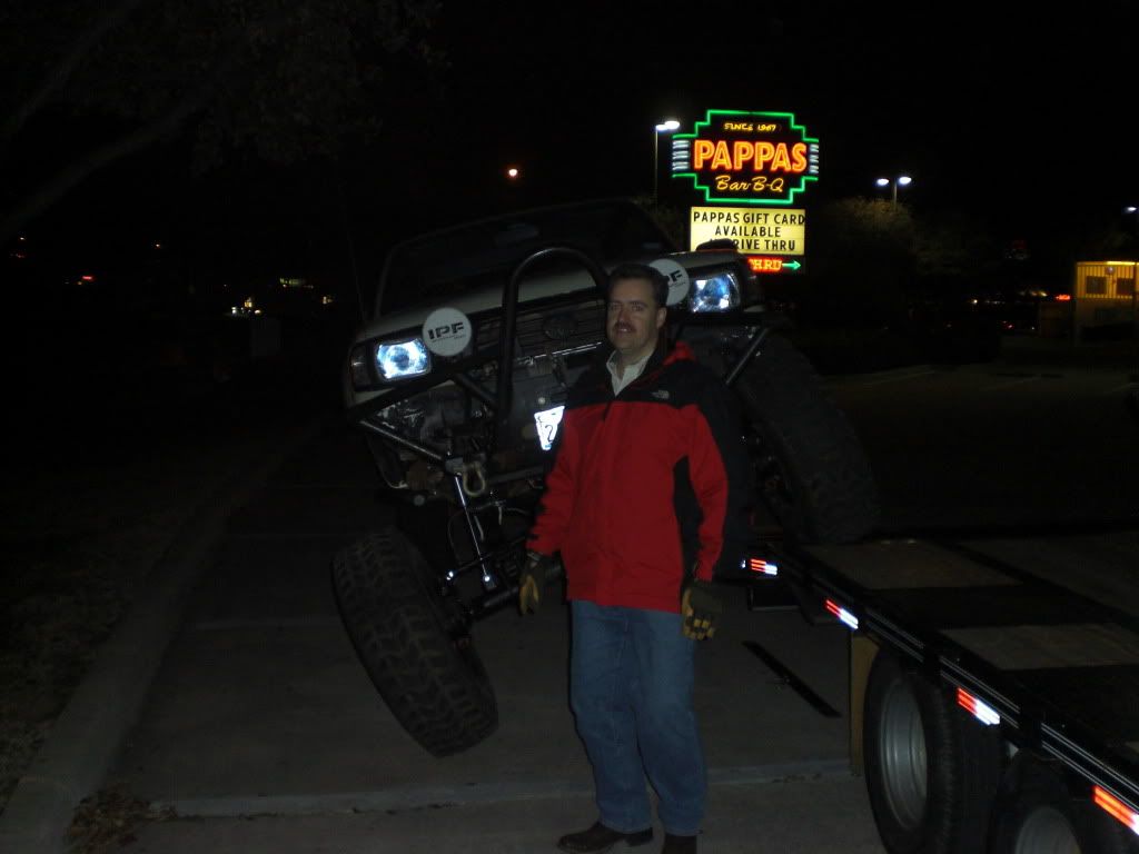

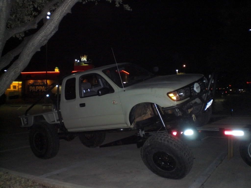

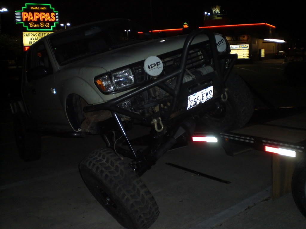

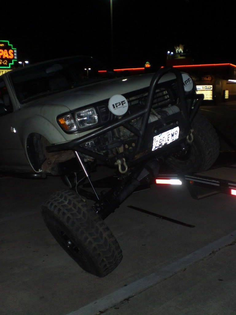

Tested the suspension on the trailer for the bump stops and grabbed the poser pics
http://i46.photobucket.com/albums/f1...a/CIMG0069.jpg
http://i46.photobucket.com/albums/f1...a/CIMG0068.jpg
http://i46.photobucket.com/albums/f1...a/CIMG0074.jpg
For reference pops is about 6' so she is still a little tall...

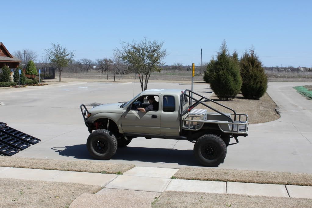

Well here is a pic in the day of the Tacoma. I was unloading it from the trailer and the wife thought it was picture time.
http://i46.photobucket.com/albums/f1...a/IMG_2533.jpg
Ok on to the nitty gritty, I would estimate it took about two hours a wheel/tire combo to unfawk the crappy ass H1 tires from the H1 rims, rip an insert out, put the insert into the tire with some beads, make sure the O-ring is seated right and not come out at the last minute and then bolt the 12 bolts down as hard as I could. It was a learning experience and next time it will go a lot faster.
