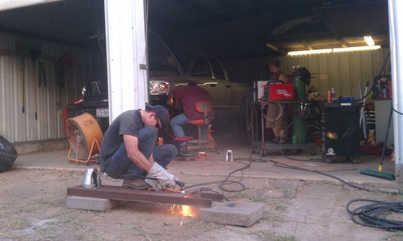

Big thanks to Sparling, Sam and Tommy for helping :gigem:

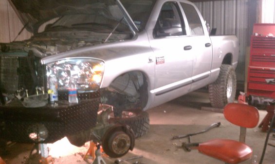

Almost done! Fenders need to be trimmed for 37's and the bump stops are stuck half way in their retainers but I can drive to school tomorrow, I'll post more pictures tomorrow.

So far:
Front:
3 inch Thuren coils
3.0 fox shocks valved by KORE
KORE sway bar and track bar
Carli control arms, high mount steering stabilizer and diff gaurd
2010 Mopar steering up grade (T-type)
Hydraulic bump stops
limiting straps
nets just shy of 11 inches of travel
Rear:
Deaver leaf springs (~1 inch raise)
Lowered factory bumps 2 inches
not sure on travel yet but it's somewhere south of 11 inches
Left to do:
Clearance front fenders for 37's
modify and install inner fenders
find some bumps for the rear
Maybe work on some rear air bags
Then onto bumpers, skid plates etc
