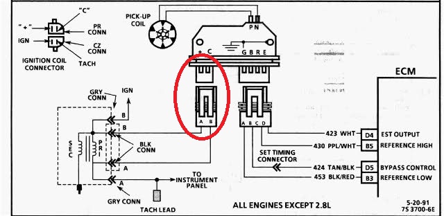

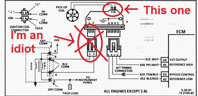

Tommy won't listen to me.
http://i246.photobucket.com/albums/g...o/IMAG0622.jpg
