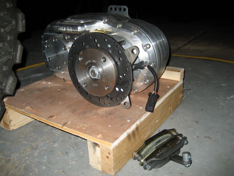

Stak finally came in. :gigem:
http://img.photobucket.com/albums/v4...5/DSC_7383.jpg
http://img.photobucket.com/albums/v4...5/DSC_7382.jpg
What ratio and yokes (they look small...)? No parking brake? Just ah 2 speed?
just given you a hard time - Welcome to the Stak club :gigem:
sweet, when do you expect to have this bad bitty on the trails again?

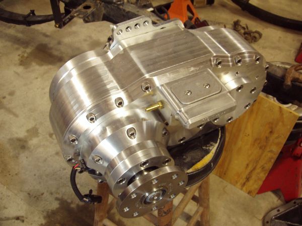

scott, do those bolts on the covers look new to you?
sweet, that should hold you out until its time to step it up to the lt230 and do it right.
yup, looks like they changed something else on them.
bearing preload? surely not.
scott's
http://tamor.org/forums/attachment.p...tid=8860&stc=1
mine
http://tamor.org/forums/attachment.p...id=10187&stc=1
1310 cv?

The yokes are 1350's, gear ratio is 4.33:1, and no parking brake or vss. Not sure when I'll get it back on the trail, alot of detail work. I have all the parts to finish it, just need the time.
There was a thread on pirate, maybe the DD Stak one, and they mentioned that they might start incorporating that into the case.
can you find the thread?
looks expensive.
http://pirate4x4.com/forum/showthrea...highlight=stakQuote:
Originally Posted by Capt. Nemo View Post
STaK also replaced the rear bearing retainers with ones that allow the bearing preload to be set from outside the case, rather than having to open it up and add shims. Ken said that the bearing preload only needs to be set once, but I'm a little skeptical since the adjustments are so accessible. Time will tell.
post #53
He was having problems with the case leaking, getting hot, and making noise like a bearing or something I believe.
Cheaper then an atlas and not much more then a fully decked out d300.Quote:
Originally Posted by Seth
Originally Posted by TxCruzr
yeah, thanks, i just found it and read it. im not too worried about it as i dont like that way of preloading the bearings. how do you know you have it loaded evenly? it should be a one bolt operation, not six. do they have shims, not washers, under the bolts, robbie?
See, that is what I was thinking. What if you accidentally tighten one bolt more then the other? Isn't that going to be worse and wear the bearing out even quicker? But then again, will you actually even need to tighten them, specially on a trail rig that won't have a whole bunch of miles on it?
I haven't actually seen it or read any of the paperwork that came with it since it came in. I had it shipped to my dad's office and he sent me a couple pictures. I'll have to look into it next time I go home.
