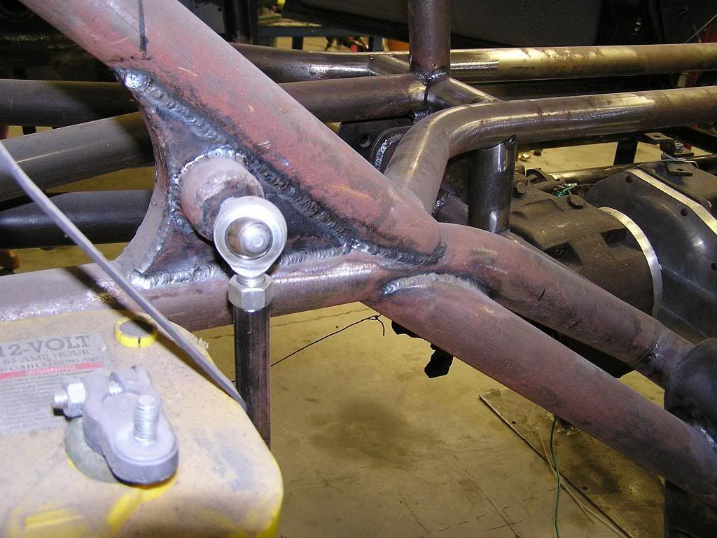

Oh, and I think it was John Cox, but somebody wanted to see better pictures of the "frame rails" so here they are.
http://i186.photobucket.com/albums/x...vframerail.jpg
http://i186.photobucket.com/albums/x...framerail2.jpg
http://i186.photobucket.com/albums/x...sframerail.jpg

wholey jeezus. Have you mentioned what most of the material is on there? 1/8 or 3/16?
Damn. I personally can't wait to see it fly.
holy hell I dont even want to know how much this thing is gonna weigh...
probably about half what you think it's gonna weigh
The guy is so unoriginal. Seriously, think outside the box, man. And would it be too much to ask for you to not steal one of your ideas from the klogger.:rolleyes:
:flipoff2:
Yeah, almost all of the brackets are a mix of 1/8" and 3/16". The tubing is 1 3/4" .120 wall, and all the suspension links are chromoly. Shouldn't really be that heavy compared to a trophy truck or the likes. You have to remember, this thing isn't being built to be some lightweight comp buggy that gets unloaded off the trailer, bashed on a comp course, then put back on the trailer for the trip home. This thing is going to be a balls to the wall, sand dunes/desert runner, rockcrawling and trail running, hauling ass down the highway, cyclone spinning, stereo bumping, windows up with the a/c cranked, high flying mushroom cloud laying mother ****er, mother ****er! Or something along those lines.....
