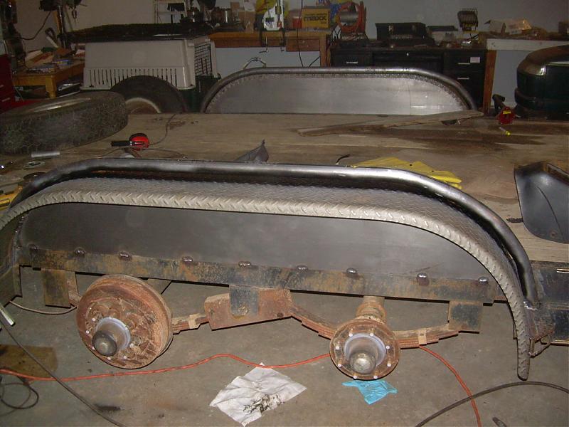

I bought my trailer without fenders and i decided that i should make it legal so it was time for some fenders. I wanted something different than a normal trailer fender and i wanted something that could be driven over and not have to worry about destroying the fender in the process. I went with the heaviest diamondplate fender I could find then used 1 3/4 .120 wall hrew to mimmick the shape of the fenders. Thanks to Karl for the extra help with the bending. They did not come out perfect but I am very pleased with how thet turned out.
