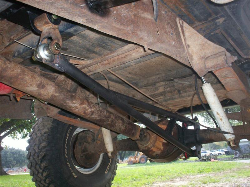

inner c is bent. either i drop more for reid c's, weld a good stock c on and run it, sell it for a rockwell front, or bend it back
i vote rockwells

anyone have advice on removing a c from the axle tube?

to remove the cut the tube from the inside in 3 to 4 places with a saxzall and it should let the tube collaspse enought that you can hammer it out, oh and heat up the ouside of the c

weld bead inside of tubing. the shrinkage will cause the tubing to pull away from the c
quick question, you trying to put a new c on the old axle, or trying to use the c off an old axle?
