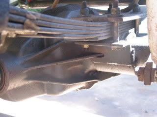

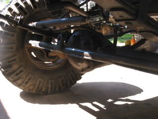

I just took some pics for reference.
http://img.photobucket.com/albums/v4...tay/fun008.jpg
http://img.photobucket.com/albums/v4...tay/fun007.jpg
http://img.photobucket.com/albums/v4...tay/fun009.jpg
looks to me like you just need a longer front driveshaft

Maybe from the pics it's hard to tell, but the pinion is definitely pointing down and you can see how the steering is angled upward. I did do a little testing yesterday driving around, and the wobble really only happens when I mash the throttle then immediately let off, which is why I said I need to make traction bars. I can watch the rear axle torque when I do this which I think is sending into the wobble. Either way, I'm shimming the axle to help out that pinion angle because it's hideous and is wearing out my u-joints prematurely.

The whole f'in axle is rotated incorrectly. Its not just castor, and not just the pinion angle, its both. When he puts the shims in, they will fix both problems, without any of this cut and turning knuckles crap. I think we are really overengineering the solution here.

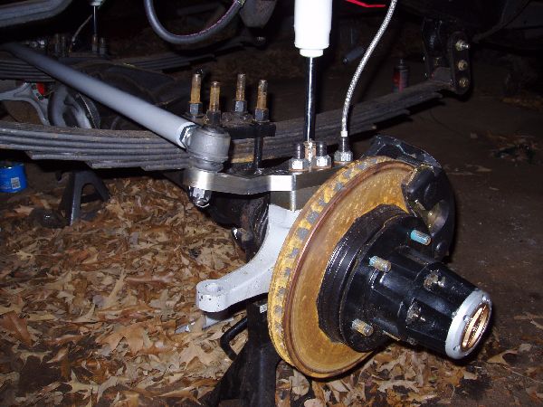

i had to use spacers and bend the arms a little because of the RS.
http://tamor.org/forums/attachment.p...tid=5093&stc=1
