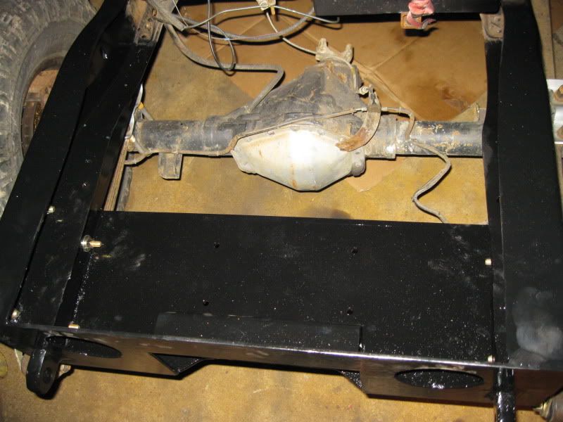

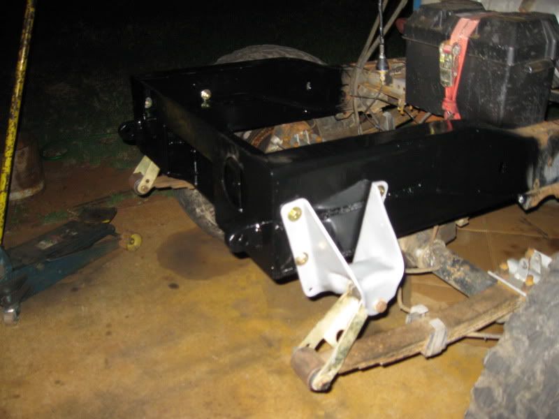

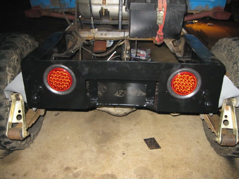

Finally got my rear winch mount/ suspension back together last night. I'm putting my M12000 in the rear and the deck of my bed will sit flat over the top of it. The free spool lever and solenoid pack controller connection will be accesable from the front of the mount (reach up and under). It will be wired to my in-cab control so the hookup on the solenoid pack will be for backup only.
Performance Truck on 21 has the best deals on high count LED taillights.

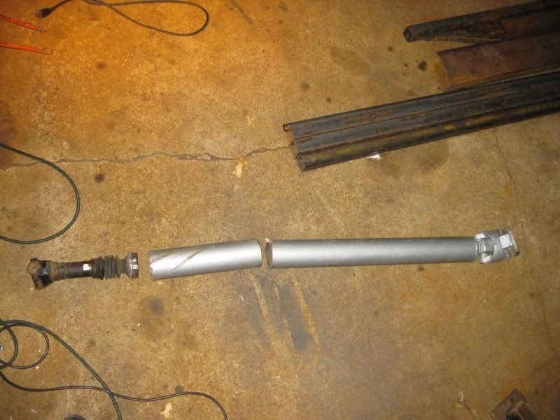

I took 13" out of the rear driveshaft.

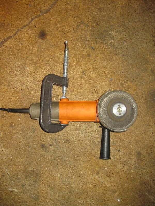

And what do you do when the brushes in your Harbor Freight grinder wear out in the middle of the night and you're not quite done with your project?...

Looks good! Pretty smrt idea on the grinder.:gigem:
you planning on a different winch for the front?
Yup, 8274.
what is that one rated at?
yeah, but is it going to be able to pull that big hunk o' american made steel? :O
he may need a snatch block depending on the situation, but it should pull without one, it will might just be a little slow
8274's are the fastest winch warn makes and I know for a fact they have enough cajones to get the job done. Not to mention they hold more cable than any other winch.
http://www.warn.com/truck/winches/src/M8274-50.shtml
I dunno what they are rated at, we have one on the front of our new turd and everyone has always said 12,000 but I don't think it is rated that high. They are definitely the fastest at 73.4 feet per minute! :eek:
You will definitely need that snatch block. :D
Is the one you are going to put on there an old one, or a newer model.
The one I am using came with a "free" 74 CJ5 attached to it, its prety old. I'll probably go through it and grease the gears. It might need to have a solenoid or two replaced as well. It worked when I got it, I used it to help pull the jeep off the trailer.
That's a hellufan acquisition there! Don't let Doug around it, he will end up 'greasing' the gears for you. :eek:
is that your HAD or a stock one? If it's stock go ahead and cut the rest of the tube off and replace it with some sch40 :D
It used to be a HAD, then I bent the tube bottoming it out on a crossmember I should have trimmed. It was then replaced with sch 40. The piece I cut out probably weighs around 10-15 lbs :laughing:
nice...carry on!
I vote sch80. little heavy but not too bad
