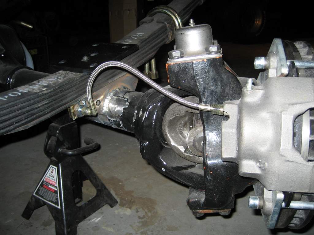

Another update to her rig: I redid the front U-bolt plates for 5/8" U- bolts. Both centerpins were broken and the plates were bent. I also reienforced the spring perches a little at they were starting to bend some. I started to make a front anti-wrap bar but got sidetracked with packing bearings while I waited for a weld to cool.
We leave for Colorado on Thursday morning, I don't think I will get the antiwrap bar done by then. It's possible but not sure I want to push that hard with all of the other crap I have to get done.
Did you have 9/16" U bolts before? Did they loosen up or stretch or something?
I had 1/2" before. They would stretch or bend the plates between runs. The grade 8 washers under the nuts have the form of the nut deforming them
Interesting, the klogger is rolling with 9/16" bolts and I made the front plates out of 1/4" plate with a 90 degree angle at front and back to prevent bending. Have to see how it works. The rear are stock plates that I welded an additional piece of 1/4" plate to.

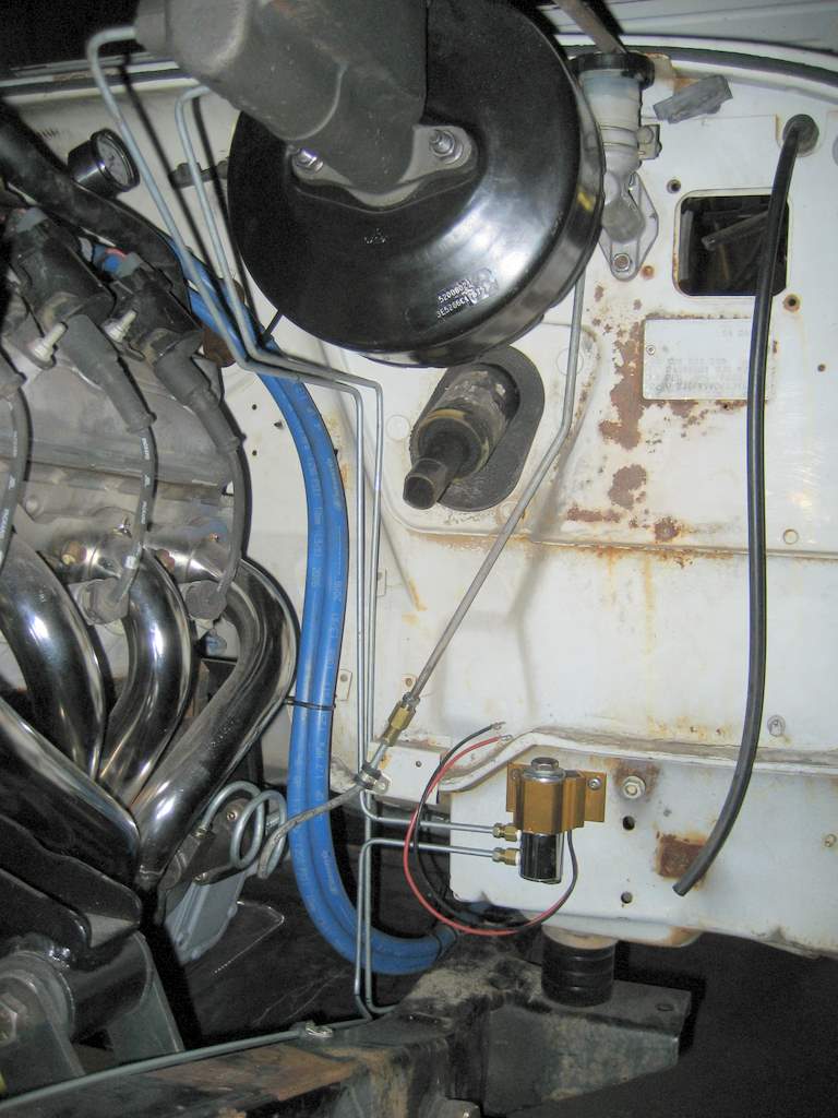

What brake master and booster did you end up going with?
Thanks
yes, that is correct. works great with some minor modifications to make it fit. I think the booster is a stock YJ one, master is vette.
Checking the diaphragm is as easy as putting vacuum to it. If it doesn't hold a vacuum, it's bad.
As far as the master cylinder, you can get one of these.
http://www.shop.sachserodshop.com/pr...categoryId=466
