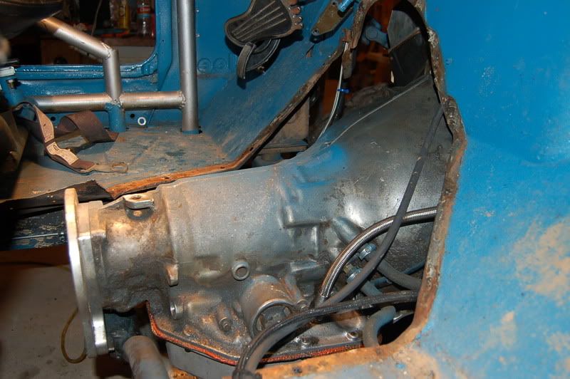

-Dropping the trans. and taking it to Ricky for a rebuild or possibly a whole new built unit.
After I get the trans back and flange/pinion brake kit installed I will get a new rear driveshaft made. Plenty of other stuff I'm working on. I'll post some pics when I get a chance.

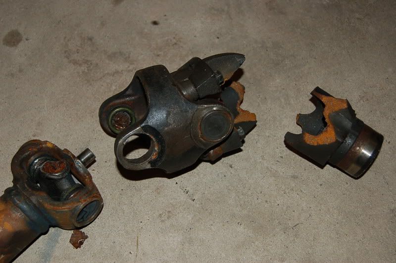

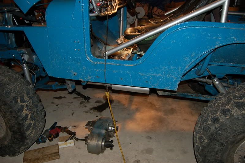

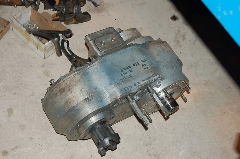

Progress from tonight. I really hadn't done anything except for pull the front hub and rear driveshaft pieces until tonight. Made some decent progress, tomorrow I'll drop the transmission then start working on other stuff. Pulling and/or installing the stak alone sucks, ended up bench pressing it down like last time. Already knew cork gaskets suck, just don't put rtv on them too.

Broken shat... Both u-joints broke, front one is wedged in the cv, shot the clip out and flared the ear around the cap.
http://img.photobucket.com/albums/v4...akedown002.jpg
1310?

Yeah what's left of them. I'm running a 1410 at the axle in the rear and now a 1350 flange at the t-case. Front is still 1350 at the axle and 1310 at the case.
