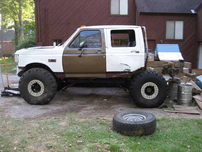

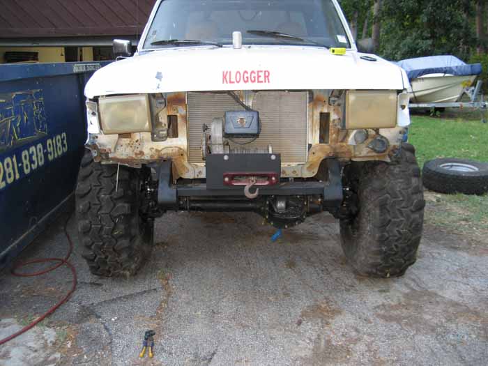

Here are some pics of the 60 swap, I say 60 swap, but it should be called the single traction beam installation with new winch mount, leaf spring conversion, high steer, hydro assist, etc..... swap.... It's taking a long time as work has been crazy. The steering is not complete, the bolts in the heims are just there for adjustment, safety washers, castle nuts, etc... will be installed, so don't bitch about that.
Oh the axle is a Ford Dana 60 with 5.13's and a lock right. Steering arms are Mad 4X4. Drag link hole is 7.75" out from center of king pin, tie rod is placed for clearance. Heims are 3/4". Outer shafts are chrome-moly, so is long side inner. Spicer u-joints. "Solid" diff cover, this thing is awesome, the cover was like $80 shipped, I challenge anyone who is looking at a weld together cover to look at this. Springs are Chevy's 2.5" wide with a full length add a leaf for wrap.
