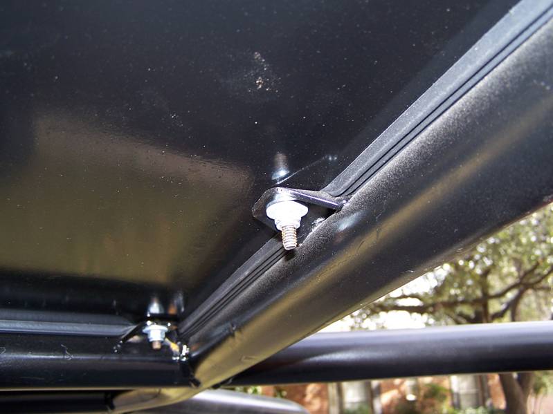

overdue pics of crossmember. 1/4" plate, 2x2x1/4" box.
I bet they are tucked up a bit better than what the picture shows, and a cutoff wheel would get rid of anything that is really sticking down too far.
