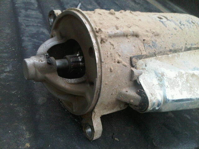

Wonder why it wouldn't start this weekend???
Attachment 19207

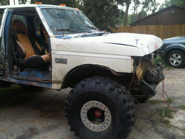

Fender damage, what fender damage?
Attachment 19206

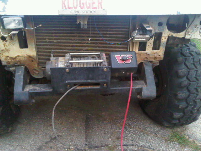

And this should fix that stalling winch problem...
Attachment 19205
