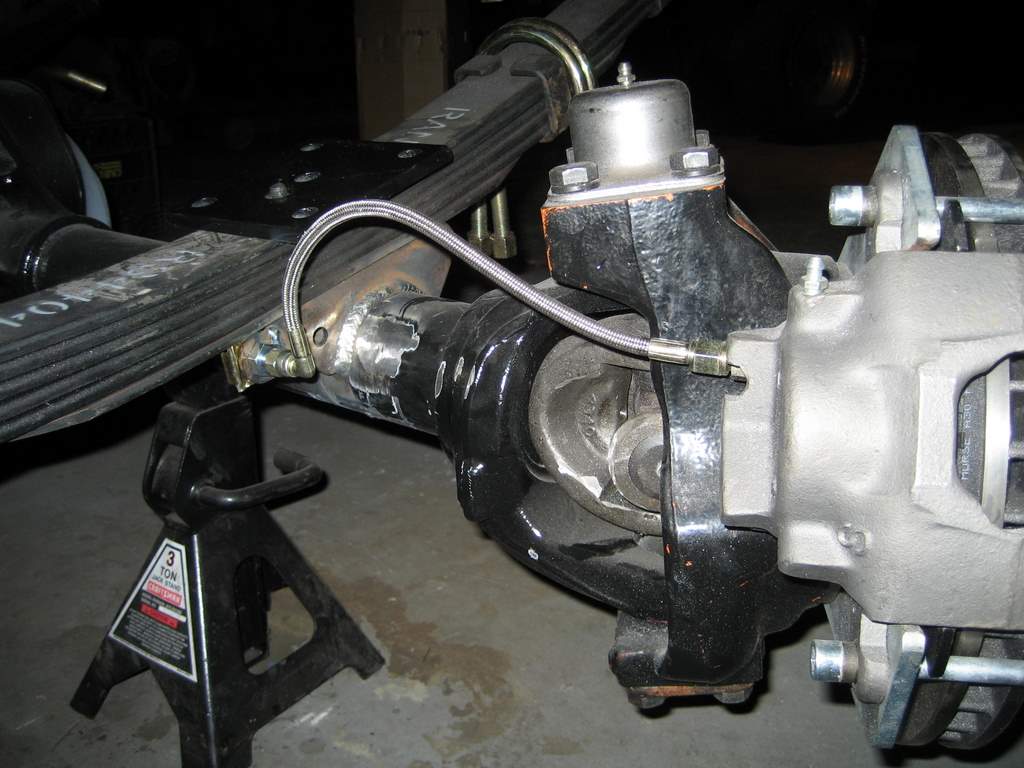

the tab under your front leaf perch makes me go, "hmmm?"
Tie Down?
brake line tab
http://tamor.org/forums/attachment.p...tid=9967&stc=1
yep - all 4 corners, outside only.Quote:
