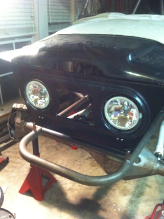

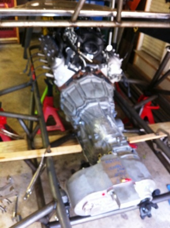

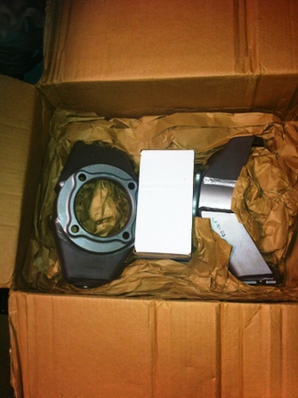

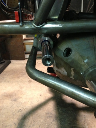

I though i would post a few picture of what i have done on this car. Attachment 19242Attachment 19243Attachment 19244Attachment 19245Attachment 19246
A few more

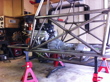

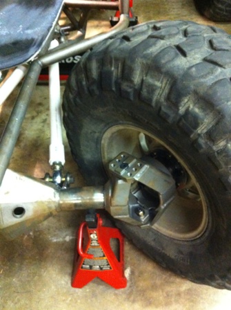

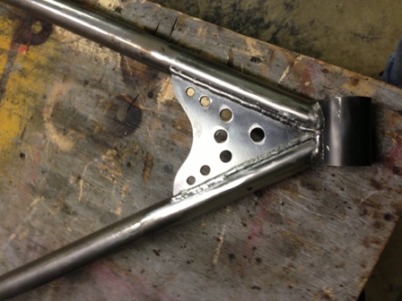

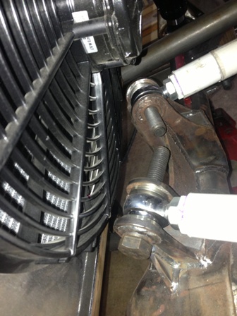

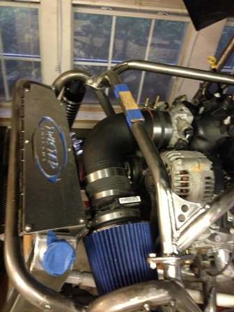

Here are some pictures of how the build is going. Still have a lot to do, but it is coming along. Attachment 19390Attachment 19391Attachment 19392Attachment 19393Attachment 19394

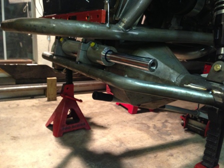

Double ended ram looks nice, you should have convinced Scott to go the same route.

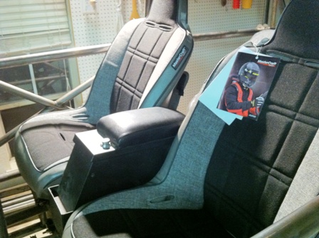

Have you sat in those seats at all??? They comfy?
Yes i have they should be very nice on the trail.
Blah - I like the way the forces go with the single ended ram. Everything pushs straight - no side loading. I think it will also look really good with the ram being hidden behind the axle.

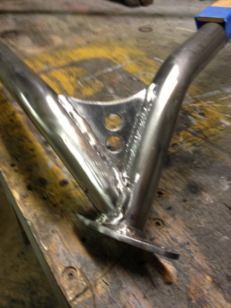

I made my THIRD set of steering arms last night, these should work, just need to adjust their location a little more from where they are currently tacked in. Turns out, 1/8" inboard / outboard or a degree off on caster makes a huge difference on the amount of throw each direction.
