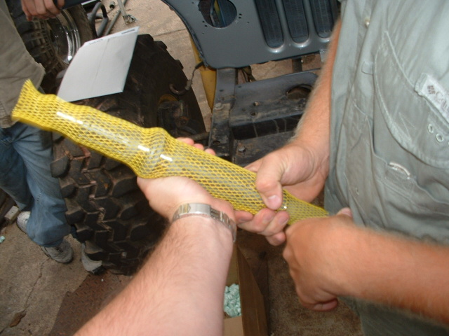

got the bellhousing/trans/tcase together, had to do a couple mods to get it to fit and a little shaving but it all fit together perfect
almost ready to put in, lengthen front driveshaft, weld up rear and its ready to go.....
What's goin on tomorrow afternoon? I got some time to do some welding.
.... until............ "houston, we have a problem"
adapter cracked... black marker is the crack... its made out of alum. and very very soft... CJ called novak and they say it happens, so there gonna replace is for a pretty good price..... so thats about a week and a half set back

i sent the adapter back to novak today...theyll take at look at it and might warranty it...we'll see
how did it break?
stud coming out of the tranny wasnt screwed in far enough and when i went to tighten the adapter down it pressed against the adapter and put it in tension and the result is shown above.....s***
At the very worst, you can take it down to a welding shop and have it TIGed back together. Probably cost $50 or so.
