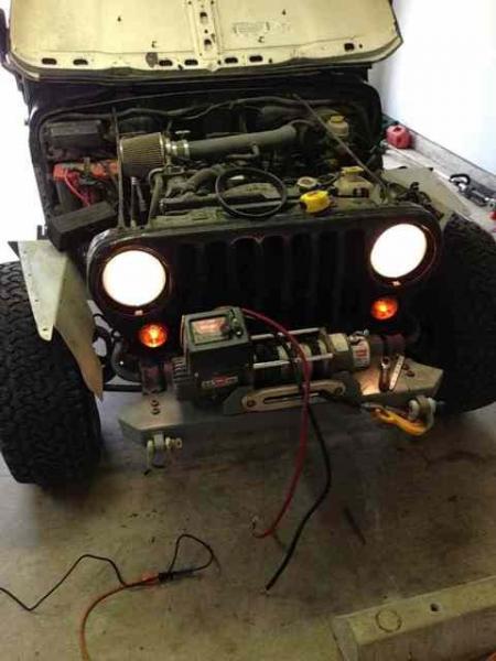

Jk turn signals. Pulled the fenders back off to repaint black
I got some 35x12.5x15 KM2s. The front looks great and it only seems to rub on the sway bar. The rear armor panels are in SA and I am going to bring them back with me next week and get them on. Problem in the rear is that the tire is very close on the front side to the tub. For my trip in a few weeks, I probably need to just do a spacer lift and mayeb some new shoks. RE spacers and new shocks run $240 so not too bad.
I still need to clean up the hood and paint it.
