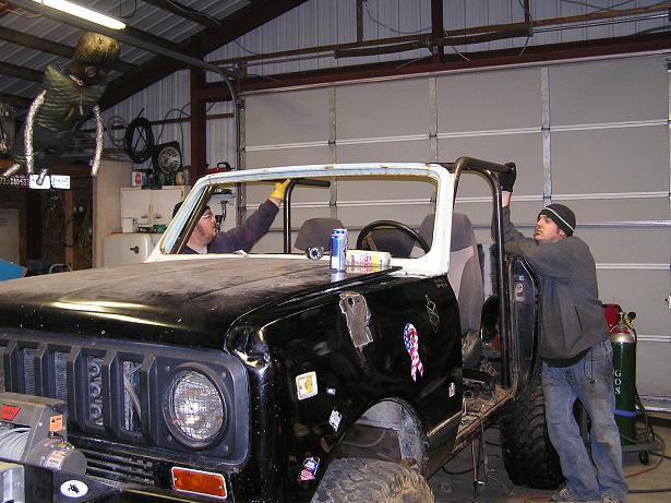

That sounds cool. And do you mean out of all the scouts yall have you can't scrounge a fender? :flipoff2:
And what is that hiding behind fred on the garage floor? Is it going to find a scout home?
dammit! in our tired state we forgot to block out a piece from the skunkworks division of BMF. Might be going in a Scout...might be going in a 71 Chevy Truck....then again, it might sit right there for the next year. :)
Oh, and believe it or not, we don't have another good passenger fender...plus, it's just going to get smashed again, so why put a decent fender on there?
Fixed it :gigem: Make sure Jimmy edits his pics before everyone sees!
Ooh I allready see.
me too

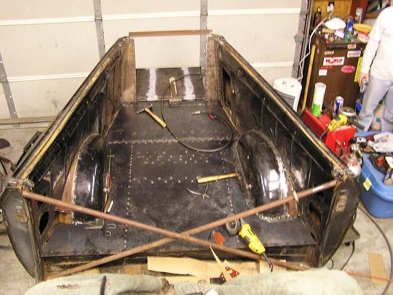

How about ending the cage right behind the wheel wells? Protects the three passengers, doesn't look so goofy going all the way back, and with the spare tire sideways behind the cage/ 3rd seat would take up most of the space between the rear of the cage and the tailgate, and keep it under my rear-view mirror vision.

I think it would look more goofy than going all the way back. what about putting a couple bends in the fastbacks, a la "brake line uterus" to let the tire get in there right up to the passenger seat?

Maybe a couple of long radius bends in the two bars that go over the rear passenger. They might look goofy on the boxy scout body, or they might look sweet, but they'd probably give the rear passenger more headroom. That, or just make him wear a helmet and let his head bounce between the bars like a tennis ball.

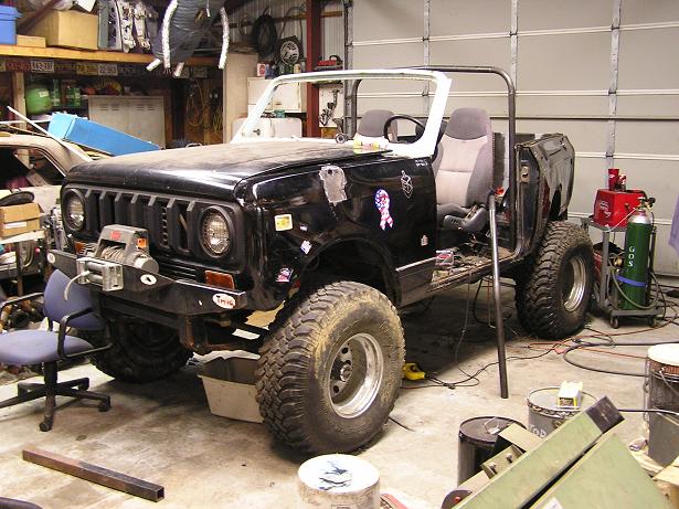

well tuesday night saw my dad even pitching in for a few tube notches. I was unaware, but evidently he is the head of the local pipefitter's union. He is a notching sunuvab!tch! St. John showed up and him,fred and robert layed hands on the oil can I had in the floor and shrunk it down so that it is tight now. Here is a shot of the cage so far.

Jason sketched a phoenix on the hood, and cage pics for tonight, front upper and dash bar, and door bars.

are the door bar and seatbelt bar not going to intersect, might look better if they did.
Hey, if you want the door bars to intersect the seatbelt bar, come on over tonight and refit themQuote:
