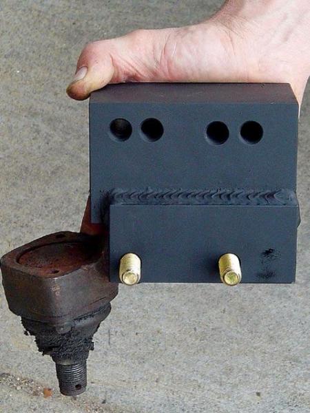

I'm still waiting for the rovertym upper a-arm extension that I ordered 3 weeks ago and the rear shocks haven't been installed yet, but I took it for a test drive anyway. I think the spindle clearances are going to work. Lots of vibes, going to swap to the series 2 CV driveshaft later this week and hopefully the rear is fixed with the a-arm extension.
so rovertyme sucks. the a-arm extension they make is a solid bar around 3x3x6, way overpriced for what it is, heavy as hell, took 3.5 weeks to get here, and it didn't fit.
The guy said I could return it, thought about it, but 2 weeks until clayton and I've got other stuff to sort out on the vehicle that requires correct suspension geometry so I put the grinder to it until it fit.
Post clayton its getting replaced with some flemco ****.
Post a pic of this thing. Sounds heavy
It's retarded how much this thing weighs, and people regularly bolt this on to their suspension.

I hope you didn't pay to much for that, could have made that for you out of scrap metal from work

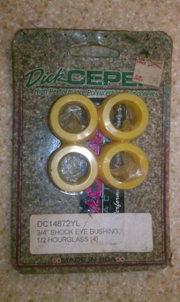

When I was planning this project I picked up a set of these from Truck Magic
Attachment 18979
Got them installed today.
