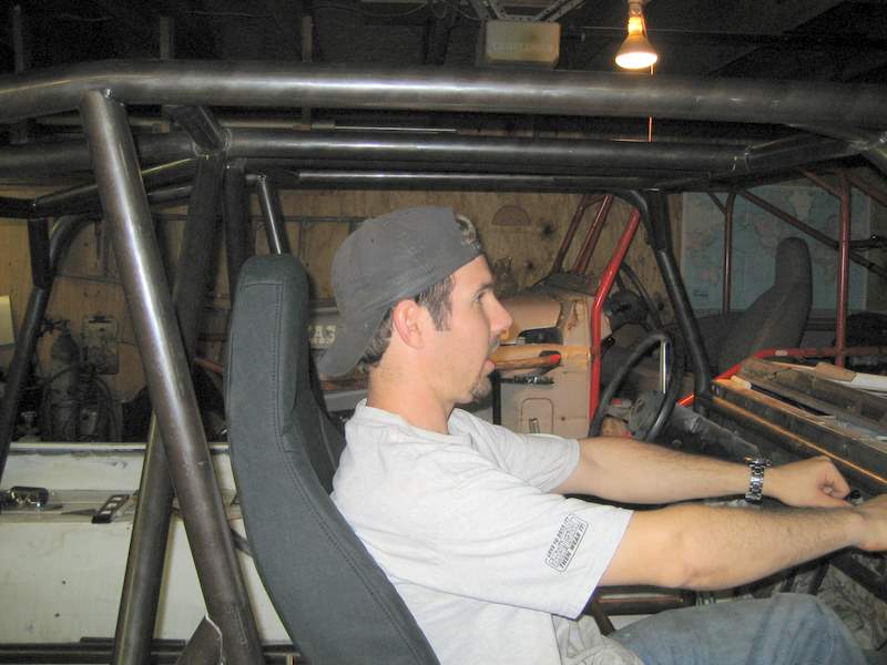

i just told you that so you wont think i copied you when i do. how high did your seats end up?
I like that front hoop :pimp:
Yes, dig the front hoop. Always liked that look.
no more bends. Where do you think I need corner braces?
a few more
you're a tool. :flipoff2:
i like it, except for the fact that its gonna collapse and you're gonna die. ;) id put braces here and call it good, but only if you really wanted braces. it would take a hard roll to shift that cage front to rear.
Yep - that was my plan, just on the front side though. I'm also going to add a spreader in the middle of the windshield
Are you going to attach the harnesses to those diagonals behind the seat or add a shoulder bar?
We really don't plan on putting the shoulder harness in the Jeep although I will probably put a tab on that diagnal bar in case we change our minds.Quote:
Originally Posted by mudtoy67
how tall are you, scott?
http://tamor.org/forums/attachment.p...id=10575&stc=1
5'-9"
cage gusset :gigem:
