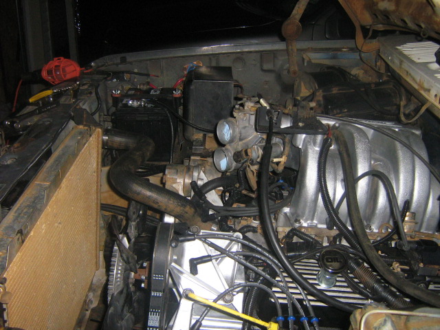

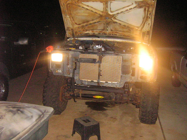

-replacement core support went in
-egr block off plate
-new battery and terminals (1000ca)
-cleaned out the radiator with high pressure, wow alot of shiloh was in there.
-new lower hose
-wires on
-all heater hoses are on
-hooked up hoses to trans cooler
It just needs the distributor stabbed and it will be ready to fire
It runs!
After a few hours of head scratching, we figured out it was 180 out. Got the timing close and it fired right up. I need to get the exhaust redone, a few odds and ends here and there, and it will be ready to roll.:gigem:
