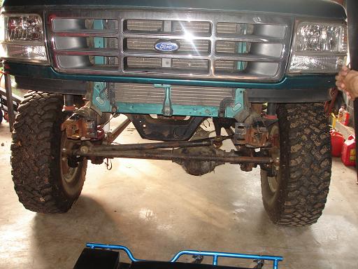

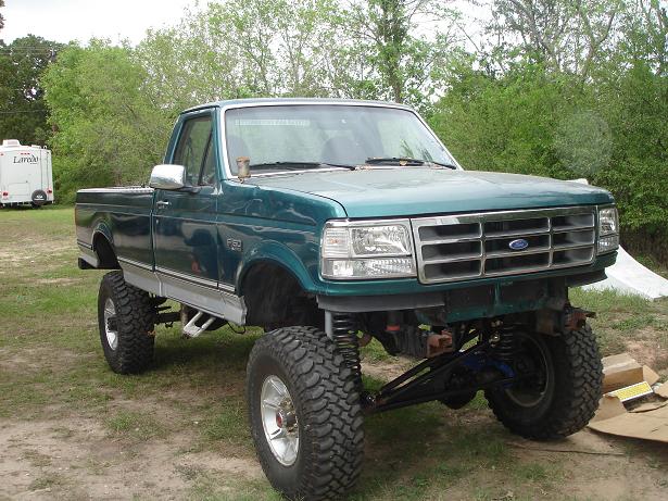

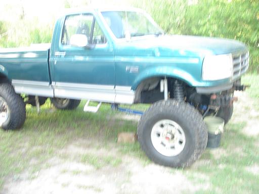

ok progress. still not driving but very close. this last week i bought a new front axle and installed it. at the same time i took out the stock coil buckets used the 78/9 style with f250 shock mounts, james duff arms and superflex 6" coils. ok enough talk.....

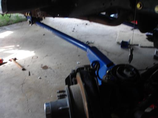

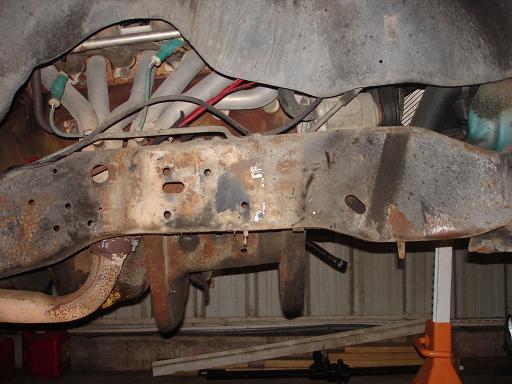

right before the start
http://www.supermotors.net/getfile/6...e/dsc01557.jpg
http://www.supermotors.net/getfile/6...e/dsc01558.jpg

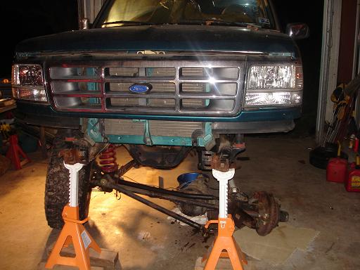

tearing it down
http://www.supermotors.net/getfile/6...e/dsc01562.jpg
http://www.supermotors.net/getfile/6...e/dsc01566.jpg

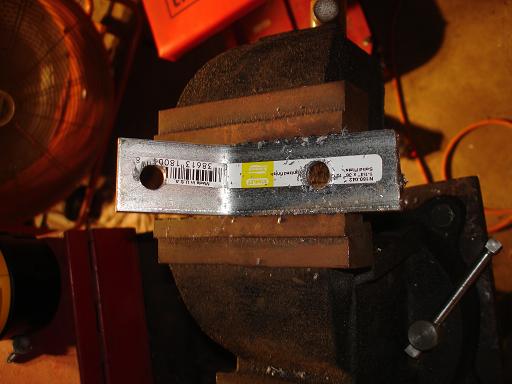

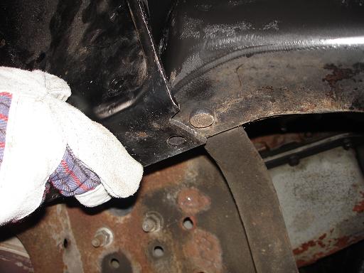

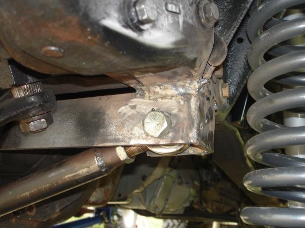

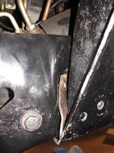

making the coil buckets work
http://www.supermotors.net/getfile/6...e/dsc01568.jpg
http://www.supermotors.net/getfile/6...e/dsc01571.jpg

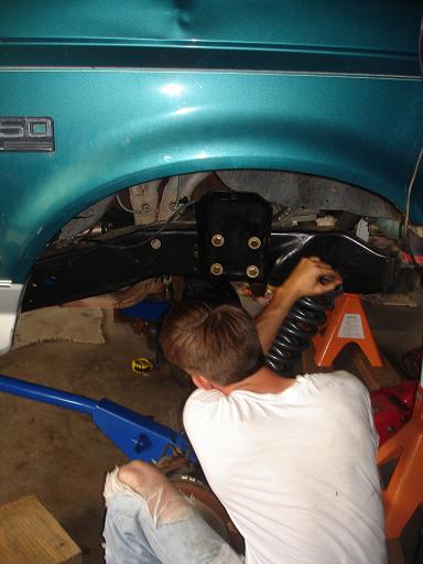

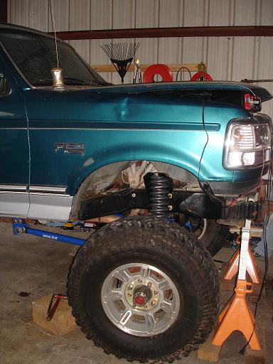

buckets installed
http://www.supermotors.net/getfile/6...e/dsc01574.jpg

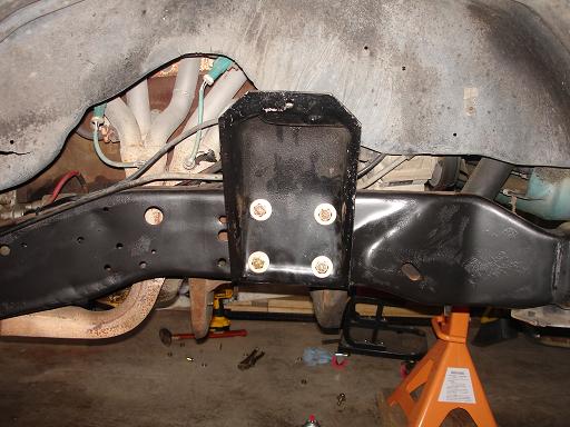

drivers side bucket where hopper made an awesome tool to get back there and hld the nut in place. the tool will stay there forever
http://www.supermotors.net/getfile/6...e/dsc01575.jpg
