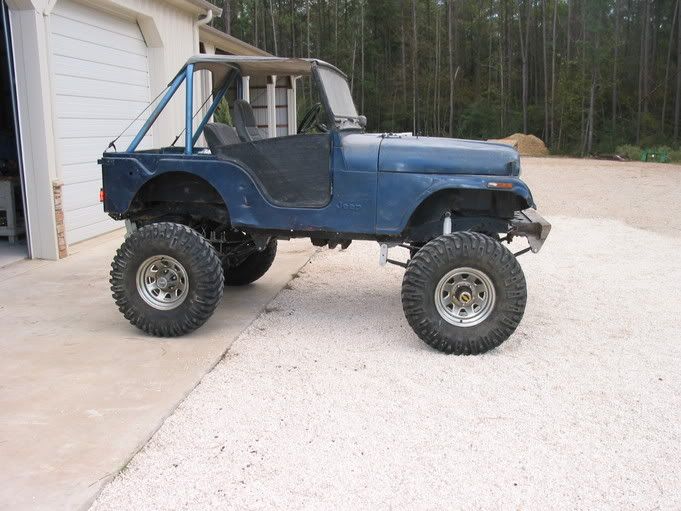

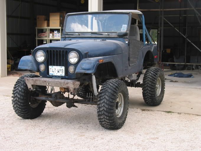

Originally Posted by uglyota
			So you're leaving those anchors hanging down there just so they match the BTF hangers?  Chop em off and put in some of these:
While you're at it, why are the BTF front hangers so low?  Are there clearance issues there?  Looks like you could lose 1/2" of lift redrilling those bad boys and grinding the bottom off.  Do the front shackle hangers sit directly under the frame rail?  Boxed frame?  You should french those too.
And Kopecki's right, no harm in using the shorter holes in the shackles...Free and easy, why not do that until your springs settle, then work from there?
