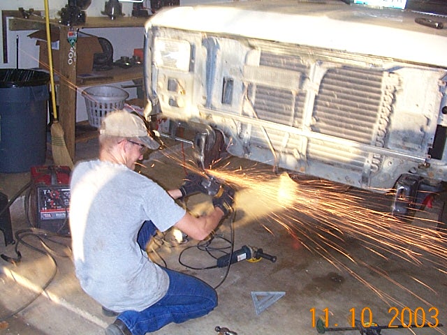

hung out with this guy this weekend. he said hello.
http://www.supermotors.net/getfile/9.../boxframe7.jpg
I must have missed the above posts. I can not even remember his name. He drove a black F150 with several large guns on the gunrack. He did the welding for me for the front crossmember and the boxing of the front part of the frame. Nice guy. I know his initials are JWB b/c he welded them onto the inner side of the boxed frame. :gigem:
