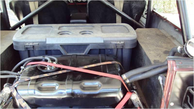

I went ahead and took the opportunity to clean/restore the fuel system. I drained the tank and cleaned the inside with some detergent and pressure washer. It wasn't too bad after all. Replaced the fuel filler hoses and fuel lines, fuel sending unit with pre-filter sock (which was previously missing) and replaced both fuel filters after purging the fuel rails and lines of the 13 month old gas. Re-fueled, and she fired right up. After letting her run in gear on jack stands for a while with no load she drove around the block just fine; or just as rough as ever:gigem:.
The ratchet straps will work for now until I build the tank into the floor and built the new faux-floor.

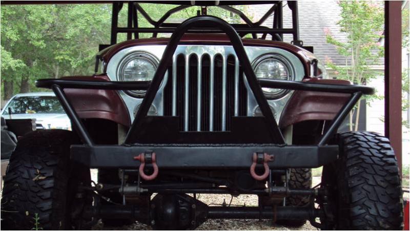

I also chopped up the front sheet metal a bit removing a portion of the front fenders so that they follow the diagonal line of the stinger/fender support tube. I also shortened the front bumper by 2 inches on each side so that the tires have an unobstructed approach.

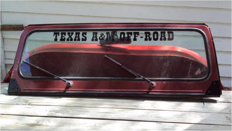

I also want to make the windshield (windscreen:flipoff2:) removable when on the trail. I didn't want to have to deal with the hinges when they were on the jeep of fear of breaking the glass. But the torx head bolts sucked and I ended up welding nuts all of them. There was some rust underneath so I just rattle canned some spots for rust protection. I think Roxanne's 'trail look' is a good one!

Removable windshield is almost done. Stripped them down and welded up the mirror arm holes. Pins are 7/16" x 3.5" stainless.

how did you get the original pins out? I tried on my jeep but I couldn't get the pins to hammer out
Well I took the hinges off first because I was scared that the hammering would break the windshield. Then I cut off 1/4" from each side of the hinge pin where it is welded to the hinge. This is two-fold. It removes the weld holding the pin in and it narrows the hinge area from 3 3/4" down to 3 1/4". This is important because the removable pin is a 3 1/2" usable length. Next, I cut the hinge apart by cutting the pin where the two pieces of the hinge meets. So now you have 3 sections of the pin in each part of the hinge eyelet. Then some smacks with a punch and mallet and they came right out.
