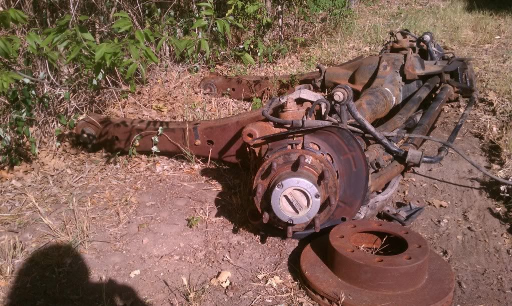

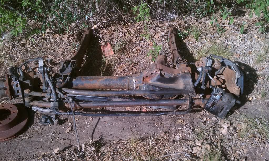

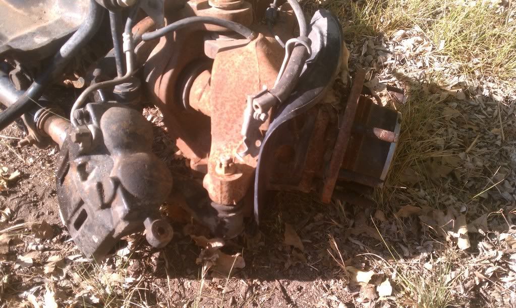

http://i736.photobucket.com/albums/x...V/IMAG0129.jpg
http://i736.photobucket.com/albums/x...V/IMAG0130.jpg
http://i736.photobucket.com/albums/x...V/IMAG0128.jpg
It is complete from what I can tell. The brake rotors look like they have never been used, it spins freely but feels tight. I think I have a good one here.
I know the wheels from 05+ will not fit the older trucks due to too much backspacing. Just curious, what's the width of the axle from flange to flange? Make sure the rear you get is 05+ also to match the width.
What's your plan for tires?
