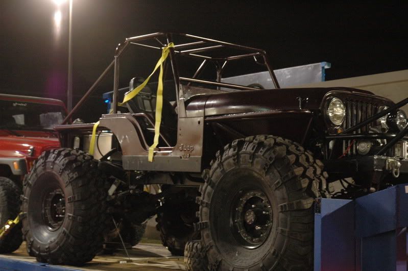

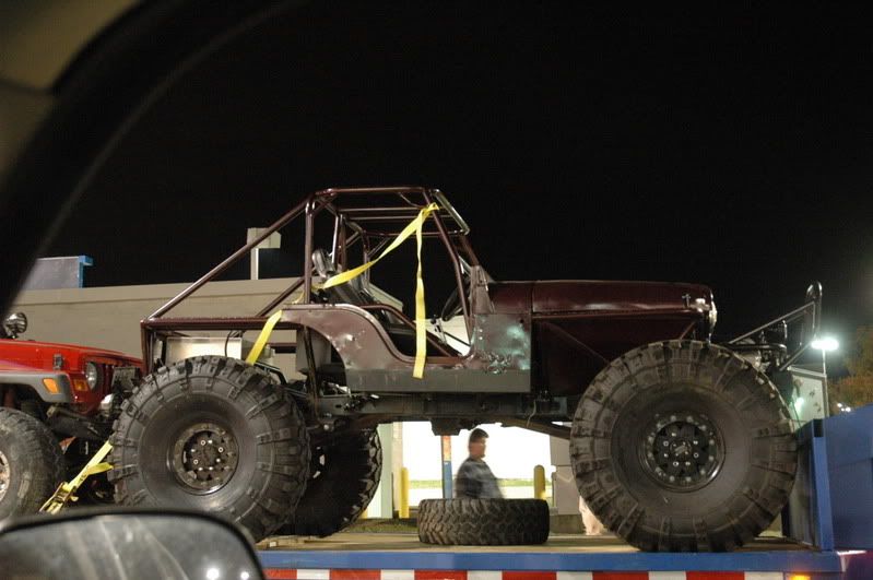

Nah, I like it soa, flexes better. The stock xj springs have some arch to them, my spring hangers are way up there and make them look flat. With the 350 being close to the same weight as the 258 it's not going to sag anymore in the front. I'll probably just remove a couple of leafs or swap to a stock YJ pack.
