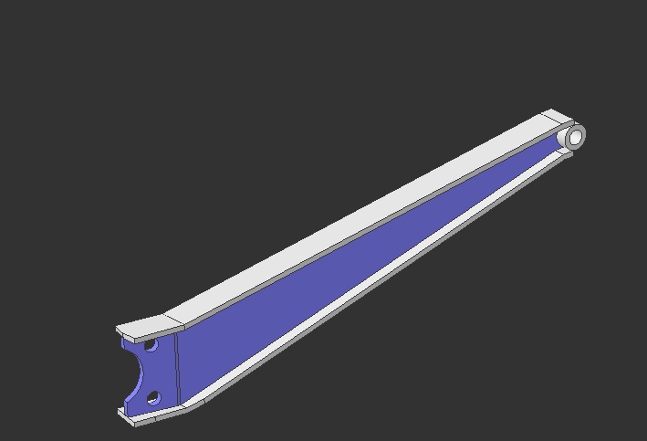

What ****ing advantage do I get from a Parallel 4 link? There's no use putting the time and money into doing that when it'll end up with the same amount of flex and a weaker setup.
These arms require no bending, just a big ass notch. I'm sick of arguing what i'm doing, i'm going to do this. The guy who built them beats the **** out of his truck and they haven't bent.
If I did a parallel 4 link I would definately need 2" 3/4 wall dom, but since they're doubled up on the radius arms i'm not sure I will. Maybe 1.75 .120 wall.

To do leaves on this axle would be more work than radius arms. If I had just built them instead of changing my mind 30 times they would already be done.
To do leaves I would have to grind off the r/a mounts (which is alot of grinding), weld on spring perches, buy leaves, weld on shackle brackets and change the shock tabs.
Doing the radius arms involves, building the arms and bolting them to the existing brackets. Coil buckets need to be worked but it's not going to be any less work than leaves.
