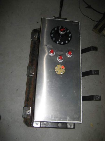

Sinking the gas tank.
http://i406.photobucket.com/albums/p...p/DSC04231.jpg
Tank hold down straps, 1"x1/8" strap
http://i406.photobucket.com/albums/p...DSC04238-2.jpg
RCI 2161a. 15 gallons. The tank is 12" tall. It will come out 5" above the floor and 7" under the floor.
http://i406.photobucket.com/albums/p...p/DSC04234.jpg

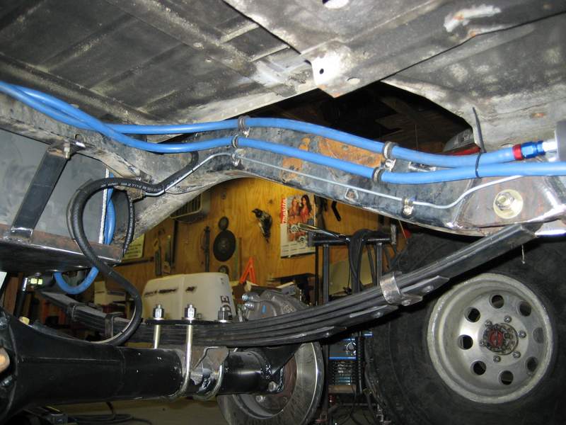

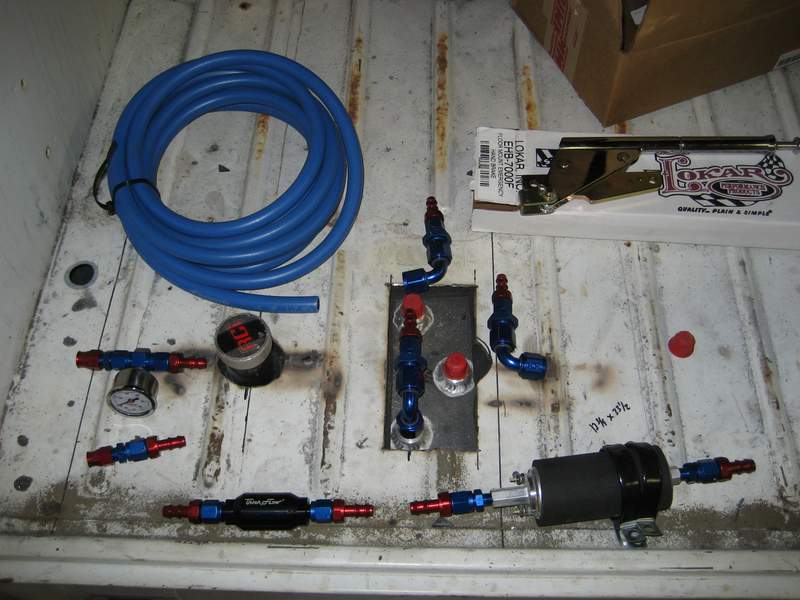

Custom AN -8 to 5/16" hose barb fittings.
http://i406.photobucket.com/albums/p...p/DSC04239.jpg

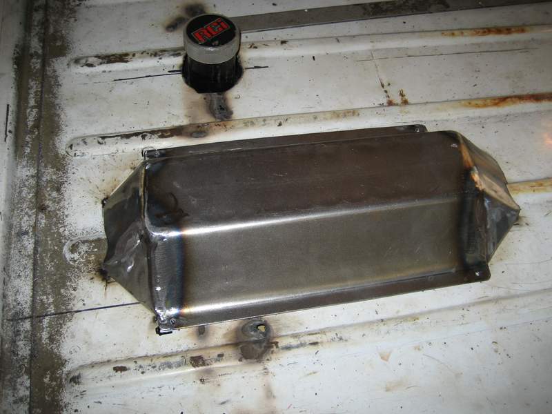

Skid plate/mount, 1/4" plate with 1.5"x1/8" angle and 3/8" countersunk bolts. It will be flush with the bottom on the frame rails.

Why did you cover up the aluminum tank with steel? Looked better before
Way cleaner install in my opinion. No plumbing to be seen and no gap around the tank to be seen. Plus I can put a cooler or spare parts/crap on top of it and not lose the storage space. . . Cjs are small enough.

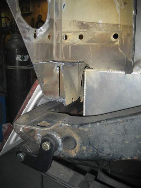

If you still need more cargo area and don't mind doing some sheetmetal work/cutting the tub, you can do what I did. It kind of depends on how wide your rear axle/tire clearance is though.
This is a pretty old pic, before rollover vents etc...but you get the idea.

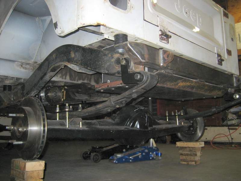

5 Attachment(s)
Or you could've been super smart and gotten that same tank dimensions with it orientated the other way and put the whole thing under the Jeep and leave that room for storage...:flipoff2:Attachment 19285Attachment 19286Attachment 19287Attachment 19288Attachment 19289[ATTACH]

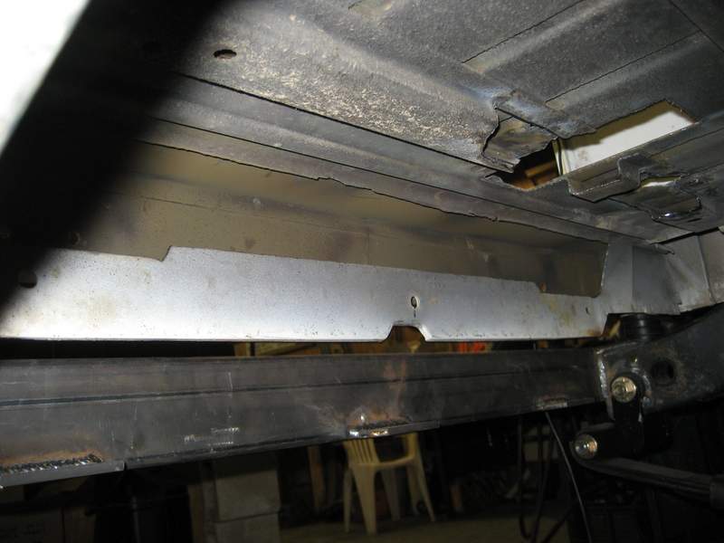

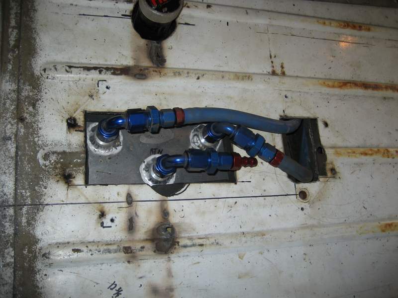

3 Attachment(s)
I had to cut a little sheet metal out back to push the tank all the way to the outside sheetmetal - to allow for the axle uptravel.Attachment 19290Attachment 19291Attachment 19292

I think it is interesting how the RCI tanks do not come with tabs anymore. Mine came with a label that explained that they are now not coming with them because too many idiots were using them to hold the fuel cell without any additional support and cracking the cells. I guess RCI was tired of the complaint calls from rednecks wanting their money back.
yep - the preferred mounting method is with the straps. I would do the same thing to get away from those customer support problems if I was them...
