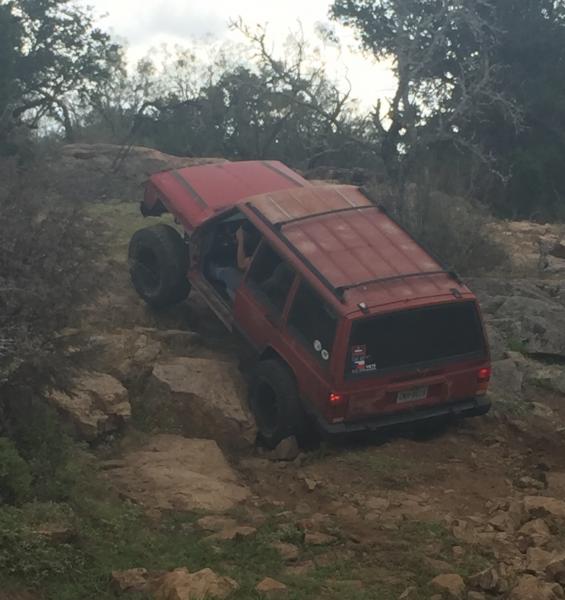

Tuck that bumper in as close to the grill as possible. I've even seen some guys cut the grill to recess the winch back as close to the radiator as possible. I've got an ARB on my XJ and it works well but just sticks out too far. With 35's I find the bumper hangs me on even mild sized ledges. I have to approach most ledges/walls at a pretty good angle to get one front tire climbing in order to get the front end up. This leaves me at some precarious angles sometimes. The pic below is from Clayton 2013. I made that ledge that year. 2014 wasn't so lucky and ended up with my passenger in the drink. :D
